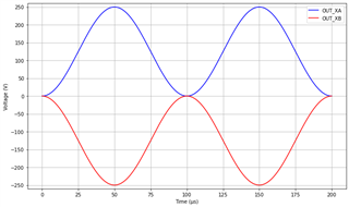

I am currently working with the ULC1001-DRV290XEVM, but I am not entirely certain how to interpret the output signal. The board indicates an output of 0–250 Vp. In the accompanying software, it is possible to set the “Amp puV” parameter. I assume that setting this value to 1 results in a 250 V peak differential signal between OUT_XA and OUT_XB. However, I would like to confirm: does this mean one output reaches +250 Vp and the other –250 Vp, creating a total differential of 500 Vp, or is the signal +125 Vp on one output and –125 Vp on the other, creating a total differential of 250 Vp? Another question, does the signal swing symmetrically around ground between the two outputs, or does one output remain at 0 Vp while the other reaches 250 Vp?
This information is important for my application, as I am using a piezo ring from Thorlabs (model PA44M3KW), which requires one side to be grounded. Would you consider it safe and appropriate to drive this piezo ring using the ULC1001-DRV290XEVM?

  • I would like to confirm that I correctly understand the appearance of the output signal. For reference, I have created an image of the output showing the signal at maximum voltage and a frequency of 10 kHz. If the actual output differs, please describe its characteristics or provide a graph that accurately represents it. I hope my image is sufficiently clear, if not, please let me know.
  • That's great to hear. So, just to confirm, does this mean that the maximum output voltage the driver can reach is 500 Vpp? As you mentioned earlier, the output voltage is not exactly proportional to the "amp puv" setting. If I’m using a piezo ring with a maximum voltage rating of 150 Vpp and I want to achieve maximum displacement, would you recommend setting the "amp puv" to 0.3 (150/500)? Or would you suggest a different approach?
  • This EVM is designed specifically for driving the lens cleaning module, not to drive a universal piezo.  The voltage applied across the piezo is very dependent on the piezo load itself. With the current LC filter configuration on the board, it may not be able to output a 150V for your piezo whatever your amp puv is.
