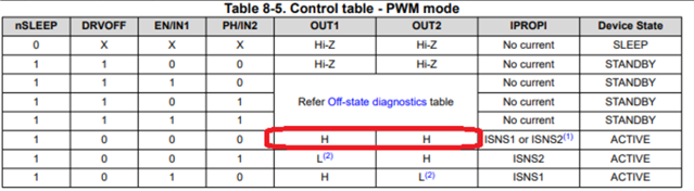

We want to use this motor for a bi-diretional dc motor application and want to make sure we handle back EMF issues. This driver seems to go into Hi-Z mode when sleeping and turned off. Are there any way of achieving brake mode or other similar protection methods while using this driver?
