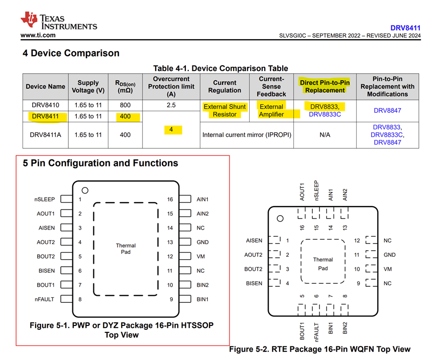

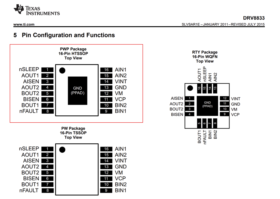

Hi Team,
The customer is currently using DRV8833 on the Novatek platform (IP CAM). If he wants to use DRV8411, can the driver be directly transferred?
  • Hi Kevin,
    Thanks for your post.
    Assuming the customer is currently using the DRV8833 in HTSSOP PWP -16 package, it can be swapped with the DRV8411 in HTSSOP PWP - 16 pin package. See below pin configurations from their datasheets. Note, in the DRv8411 there is no VINT replaced with NC, capacitor no longer necessary (cost saved) and VCP  replaced with MC, capacitor no longer necessary (cost saved). Bridge control logic are identical. Thank you.
