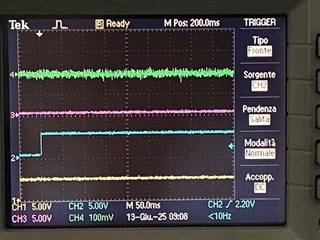

We are using a DRV8428RTER on a simple board to drive a small step bipolar motor (winding res: 60ohm) at 12V supply.
Unfortunately we can't get any output to drive the motor windings.

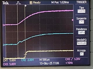

We have tied nSLEEP to VM: we get stable DVDD as expected. (img. 1).

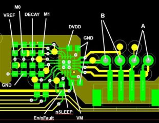

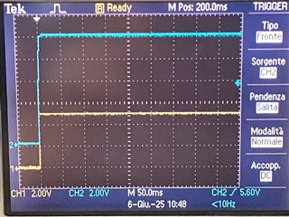

We tried, then, to rise ENable after some seconds.  We connected EN trhough a 220k resistor and a 22p cap, to use nFAULT as indicated in Fig 7-15. Rising the EN resulted also in nFAULT to rise, stable.
Am I right to expect that both windings should be, at this moment, active with, in this configuration, 100% current?  We see no variation at the terminals of windings. (see img. 2)
Trying to pulse STEP doesn't change anything.

Img.1 : Ch1 VM ; Ch2 DVDD
img 2: Ch1: yellow  nFAULT; Ch2 blue  ENable; Ch3 pink DVDD; Ch 4 green voltage across A+/A- (channels are insulated)

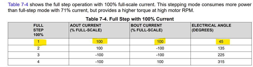

    Yes when setup for Full-step 100 % the home position default with no STEP pulses applied.

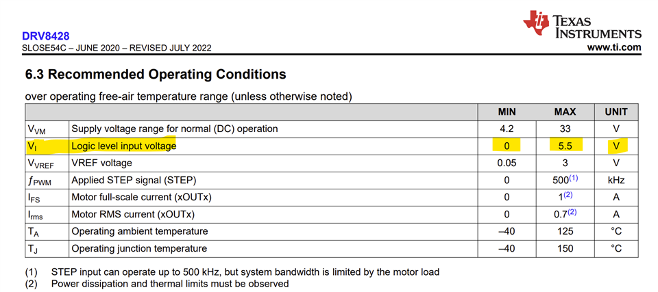

    With 33k and 3k3 potential divider from VDD 5 V TYP would result with VREF = 0.45 V which would be IFS = VREF/3 = 0.45/3 = 150 mA. With VM = 12 V and winding R = 60 Ω the max possible current would be 200 mA. So IFS = 150 mA is a reasonable setting with current regulation. DECAY to GND selects STRC decay mode which is fine.

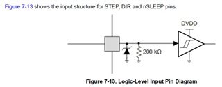

    The schematic looks okay. Like you mentioned nSLEEP is tied to VM. The VIH specification in the data sheet is 5.5 MAX - see below although the abs. max is VM for this pin. I don't think this would be the reason for the issue because VDD comes up to 5 V suggesting device is awake.

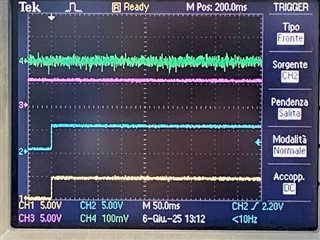

  • Many thanks Murugavel,
       we chose to drive ENable with 220k to take into account the internal resistors 16k and 2Meg; I repeated test with just 10k: no apparent change.
    Ch1: DVDD; Ch2 (trig) ENable; (ch3 -); Ch4 across winding.

  • Additional Note on nSLEEP:
    given the configuration of nSLEEP input pin:
    I've tried to connect it to VM through a 390k resistor with OK results:  Ch1 DVDD; Ch2 nSLEEP pin; Ch3 VM pin.
    Does not seem to have any concern in terms of timings.
    What concerns could arise driving nSLEEP with series resistor to VM (10V in this case)?

    I understand your thought process and comment with this. We will review the wording for future datasheets. That said, nSLEEP is a digital input with VIH and VIL specification in the datasheet similar to all other digital input specifications. For proper digital state VIL and VIH must be in compliance. Having an absolute max. specification does not mean it can be used for functionality. For example absolute max for VM is 35 V and operating VM max is 33 V. Our recommendation does not include > 33 V operating voltage. Absolute max is the point at which the device is expected to get permanently damaged. We've explicitly mentioned in the "Recommended Operating Conditions' the logic level input voltage MIN and MAX, must be complied. Anyways, glad you got it resolved.

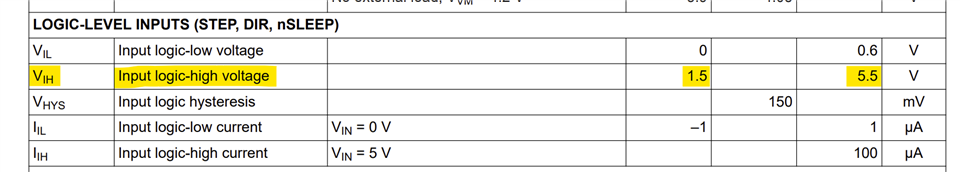

  • Hi Fabio,
    As long as the logic level for VIH is in compliance i.e. >  1.5 V and < 5.5 V a potential divider type solution is acceptable. Thank you.
