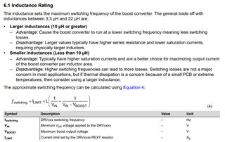

- I could only find information about the switching frequency in the configuration guide, but, if I'm not mistaken, the equation and the 1MHz value given in the guide don't fit. (see screenshots)

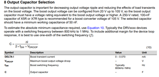

    I'm not sure I understand your 3rd question. Equation 4 in that guide is for Fsw. Equation 10 is for the boost capacitance. I think each can be considered separately. I tried a few values, and they seem valid. The hysteretic boost will change the switching frequency based on the loading.

    Regarding the switching frequency, I wasn't refering to equation (10) but to the values presented in the table below. When I compute equation (4) I get a approximate switching frequency of 100kHz (Ilim = 1.9A, Vdd=5V, L=3.3µH and Vboost =105V) while the table in section 8 gives a typical switching frequency of 800kHz-1MHz.
    I also considered that there whas an error in equation (4) and modified it as follows : Fsw=Ilimit*(1/Vin +1/(Vin-Vboost))/L. Is it correct ?

  • Hi Gaël,
    Ah, I see the issue. I missed it the first time and was subconsciously inverting the answer. You were close, but you can't just move L to the bottom, you need to invert the result. Equation 4 is wrong and actually calculating the time period, t = 1/Fsw.
    The units for Equation 4 are: A* ((V*s)/A) * (1/V) leaving only time (s=seconds) once A and V cancel out.
    So using those values you get 1.19e-6 which converts to 839kHz, which falls in line with the values in the table under equation 10.
