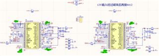

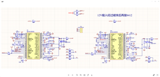

   MP: When using the 8412 parallel drive output and increasing the drive current solution, the peak-to-peak output current of the chip is 7A. The IC is prone to protection. What is the reason for this?
The current configuration resistance is 27K,  Two chips are connected in parallel with three half-bridge outputs to drive a three-phase stepping motor.

  • Hi  Mojtaba
        thank you  ,  Now, even when I'm not connected to a motor, I still have a drive protection (this drive is connected to two phases of a three-phase motor), with only the FAULT pin being 0 and the OWT pin is 1 ,
    As long as there is a problem with this board, it will always be like this. Even repeated power-off and power-on operations won't work.

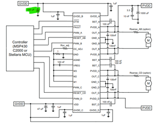

    3- TI recommends to use a bulk capacitor on GVDD pins (Highlighted below) to prevent any dip on GVDD voltage. Could you please confirm it on your design.
    4-Is there a reason that you used different capacitors 1uF and 10uF on the GVDD pins.
    5- How much is the L values on the output pin. Why did you use them?
