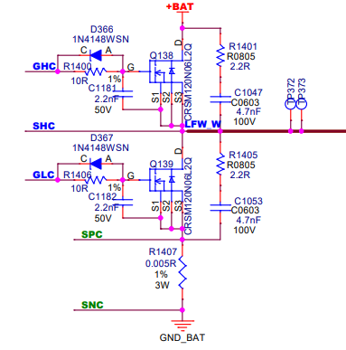

I want to know how to protect my mosfet below these situation:
1 - When my motor is running,SHA short to GND
2 - When my motor is running,SHA short to SHB.
I tested these two situation,my mosfet burned.

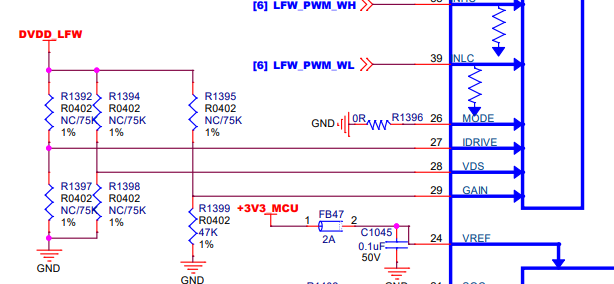

Hello Yx Yan,
Thank you for your patience. The Vds monitors help shutdown the FETs in these instances - depending on what you've set your Vds trip threshold at. Could you share that value with me?

Thank you for the schematic! We will aim to provide a response this week.
Anthony Lodi
Hello Yan,
From the schematic, it looks like your VDs Trip Threshold (VDS_OCP) is set at 1.13-V. What is your motor current?
If the product of this current and the Rds(on)-max for your FET (link to datasheet) is less than your trip threshold (1.13-V), then overcurrent protection will not kick in.
