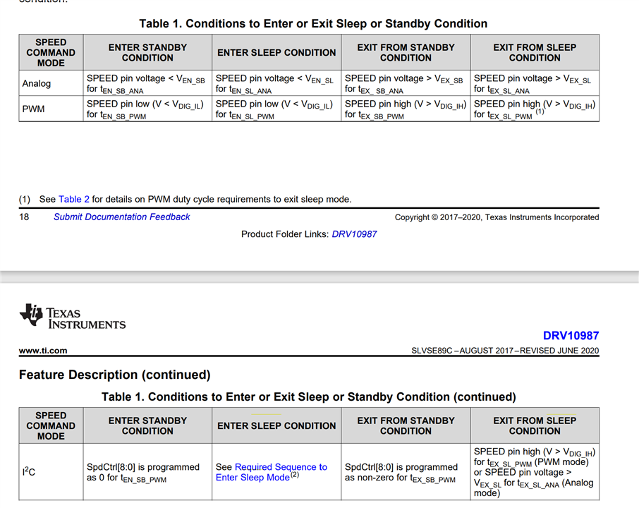

If I am controlling motor speed through I2C SPEED_CTRL register 0x30, with Bit 15 override = 1, what should I do with SPEED pin? Leave floating, pull up or pull down? Thanks
Is this DRV10987D which is sleep mode device, in this SPEED pin has to be high.
Please check the table for sleep/standby entry exit criteria
