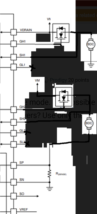

DRV8702-Q1: Is it possible to leave the low-side outputs unconnected in these drivers? Use only the high-side outputs to drive two motors, leaving the low-side outputs floating.

  • DRV8706S-Q1 and DRV8702 are H bridge drivers with Independent Half Bridge mode. Is it possible to leave the low-side outputs unconnected in DRV8706S-Q1 and DRV8702 drivers? Use only the high-side outputs to drive two motors, leaving the low-side outputs floating.
    Just as an example for DRV8702, I am attaching a circuit diagram

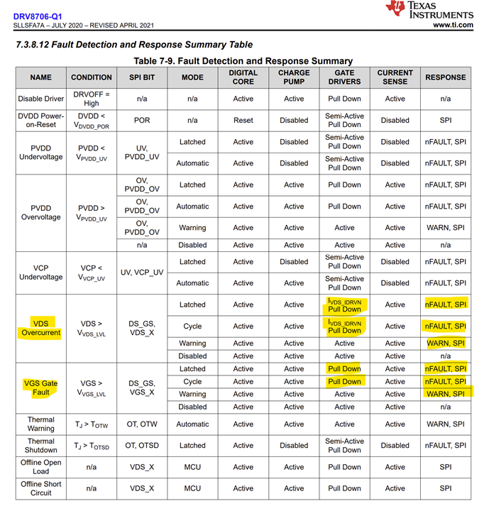

    If you do not have the low-side drivers how would the current recirculation (freewheeling) take care of? At the minimum you may have to substitute the LS-FET body diode with an external freewheeling diode.
    That said, these smart gate drivers monitor VGS and VDS voltages. If there is no LS-FET connected this will result in VGS error and VDS overcurrent OCP error. You should take care of these, else the driver could be disabled depending on the settings used. VGS is also monitored for dead-time handshake. So you must use fixed dead time setting to avoid any issues. Thank you.

    We have a freewheeling diode connected externally, and we will disable all errors related to the missing LS FET. We are already following this approach with the DRV8106S in one of our product to drive a single motor.
    Could you please confirm whether it is possible to leave the LS output open in the DRV8702 and use only the HS output to drive two motors same as above?
  • Hi Sajan,
    Assuming you have addressed freewheeling diode and the errors the general answer would be, yes. However, we don't have a visual of your application system schematic. Please share the complete schematic including load connections and the registers settings if you'd want us to review and comment. Thank you.
