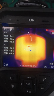

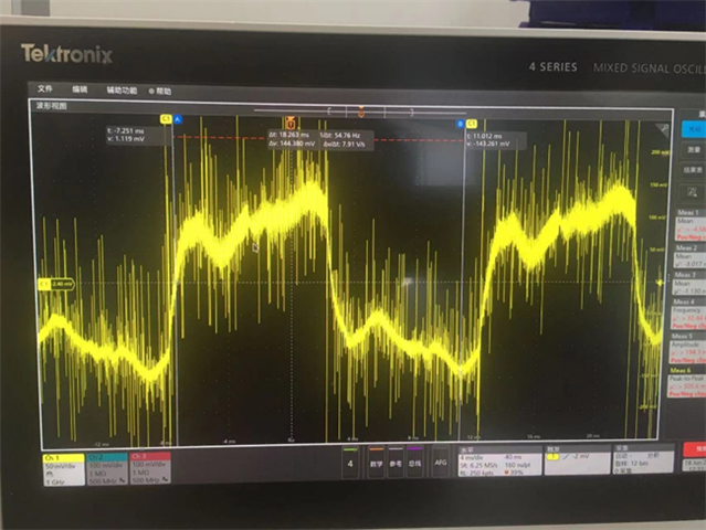

The HR8825 test current waveform and expansion valve temperature are shown in the following figure:

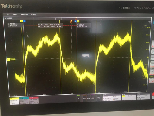

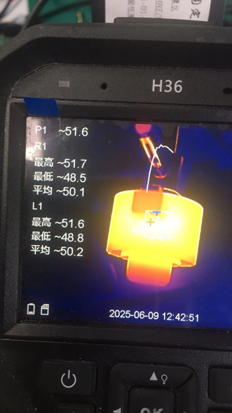

The DRV8424 test current waveform and expansion valve temperature are shown in the following figure:
From the test results, it can be seen that the current waveform is basically consistent, and the TI chip has fewer spikes in the current waveform and a clean waveform. The temperature in the picture is the continuous operating temperature of the electronic expansion valve. The temperature of the expansion valve driven by HR8825 is 49 degrees Celsius, and the repeated test temperature is 45-46 degrees Celsius, taking the maximum value. The temperature of the expansion valve driven by DRV8424 reached 52 degrees Celsius. Excessive temperature can affect the lifespan of the motor.

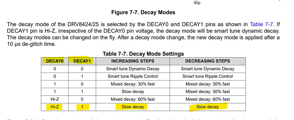

    For full-step mode with the DRV8424 I'd recommend using the slow decay setting. This will minimize heating.

    For full-steps mode the DR8424 must be set to slow decay for lowest motor heat. In addition choosing higher TOFF will reduce the heat - the customer is already using these settings, looks good. The DRV8424 utilizes the currently shipping latest stepper driving technology in our portfolio.

    For VM = 12 V and stepper DCR 100 ohms, like I said previously the maximum current through the coils cannot exceed 12/100 = 120 mA regardless of the VREF setting. This also means there will be really no current regulation happening because the current will never exceed ITRIP is VREF is set to drive higher than 120 mA. But generally for this motor current regulation would not be necessary in full-step mode because of high DCR already.
    Can the customer capture output current waveform with VREF set to 132 mV (0.132 V) and AOUT1 and AOUT2 waveforms and share with us? Thank you.
