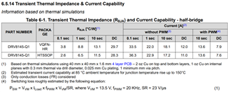

Can I use DRV8145H-Q1EVM to drive following spec of motor? I don't see any heatsink attached to it and I wanted to clarify about EVM capability..
  • Brushed DC motor
  • 28V
  • 3.5A DC
  • A Full-bridge configuration will be used
  • IN1 and IN2 will be DC (100%)  not PWM
  • Hi Samuel,
    The DRV8145H-Q1EVM should not have any issue with driving this motor although the DRV8145-Q1 is only a single half-bridge so two EVMs will be needed to have a full-bridge configuration. If you are using a full-bridge configuration I would recommend taking a look at the DRV8245-Q1 or even the DRV8244-Q1. The current capabilities of our devices is given in the Transient Thermal Impedance (RθJA) and Current Capability table in the device's datasheets.
