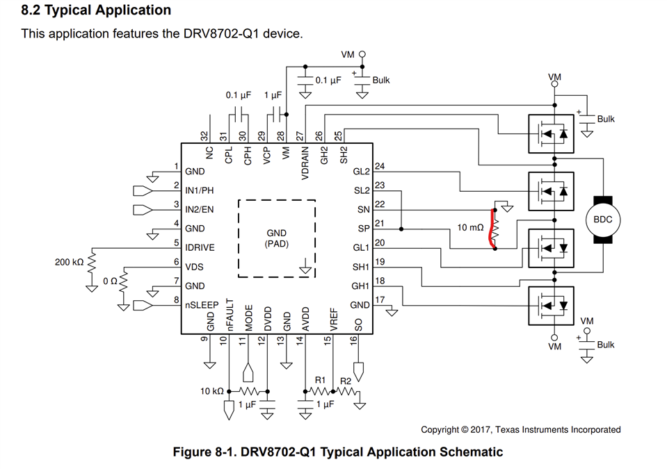

    It appears you are looking for how to disable the on-chip current regulation PWM. Shorting the current sense resistor will disable the current chopping. SN and SP must be tied to GND. Please clarify if this was what you were looking for.
    1) Can I use the DRV8702-Q1EVM board to control the inductive load without PWM?
    Typically yes, as long as the inrush current does not exceed OCP threshold which is set by VDS. Thank you.

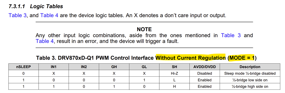

  • Thanks Murugavel for your reply. Yes, what I needed is to disable the PWM mode. I did it by using MODE=0 by connecting MODE to GND. I also set VREF to 3.3V or AVDD. In the end, I was able to control the board using the MSP-EXP430G2ET board. After disabling the MSP430 on the DRV board (by rewiring the J2 connector, moving the jumper to PUSH pin and connecting RST pin to GND), I did the following connections:

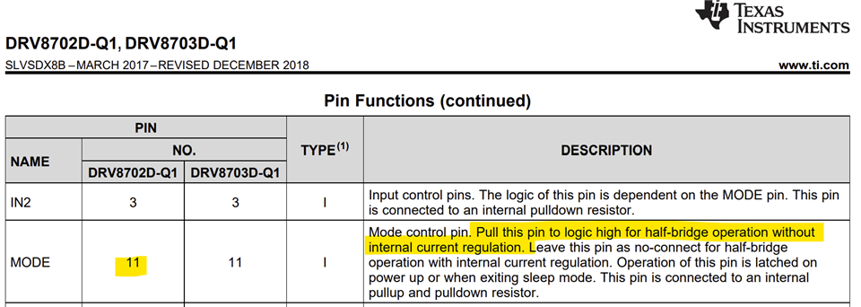

    • Set the DRV board to MODE=0 by connecting the MODE (J4 pin 11) to GDN.

  • Hi Alfonso,
    Yes, I didn't notice the MODE pin. This would be a better option to disable current regulation. However, per datasheet MODE pin must be logic high for disabling current regulation.
