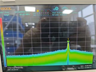

Hello!

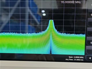

After removing the pump capacitor on our side, we found that there was no attenuation at the 95M frequency.
Using the near-field antenna of a spectrum analyzer to scan the DRV8329 chip and its vicinity, strong radiation frequencies were received. Could you please explain how this frequency is generated by the chip and what solutions are available? It seems like the chip itself is emitting these frequencies.

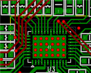

  • Hello! Thank you for your patience. None of the parts in our device operate at that frequency. So, I have some questions (and tests) that would help us to figure out where this spike radiation stems from.
    - What were the other conditions around the test you conducted?
    - If the device is in SLEEP mode, do you observe any readings?
    - If your configuration allows you to, remove the 1uF ceramic capacitor between AVDD and AGND to see and conduct the same test.
    - Otherwise, could I kindly see your current AVDD-AGND-capacitor placement and routing?

  • Hello, the test condition is that when the SLEEP pin is pulled high, the motor does not rotate.
    After SLEEP is pulled down, the frequency point disappears.

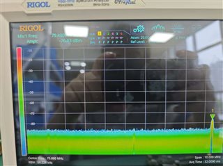

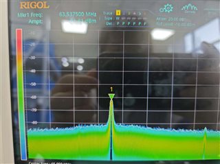

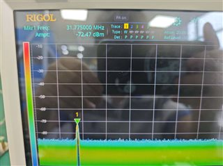

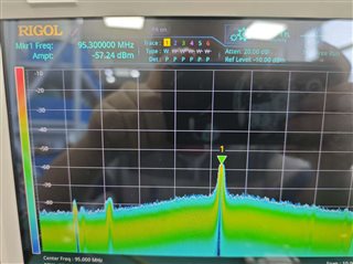

    We conducted a full-band frequency sweep here and discovered the following frequency points:
    31.77MHz, 63.5MHz, 79.4MHz, 95.3MHz, 127MHz.
    95MHz should be tripled in frequency. Switching to another chip may introduce slight errors.
    Please help confirm whether the DRV8329 has an internal frequency of around 31.7MHz and the corresponding solutions.
    After removing the 1uF capacitor, the frequency point still exists.

  • Hello - It does appear as though these frequencies are harmonics coming from our device and is related to circuitry on AVDD. Minimizing the inductance in the ground loop between the AGND pin and C_AVDD should help reduce the magnitude of the observed frequencies.
