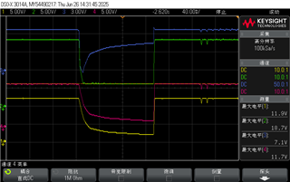

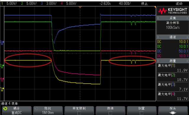

When the product operates at -20 ℃, the input voltage of LM5007MMX/NOPB is around 22V. The 12V output of BUCK will lose power, and after about 200ms of power loss,
it will resume outputting 12V. After about a minute of recovery, 12V will lose power again, repeating the cycle. The junction temperature of LM5007MMX/NOPB is -40 to 125 ℃, and the problem only occurs at -20 ℃.
There is no such problem at room temperature and 60 ℃. I want to confirm if LM5007MMX/NOPB is working abnormally at -20 ℃.

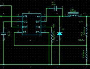

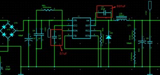

The below is our schematic diagram for your evaluating, thanks.
