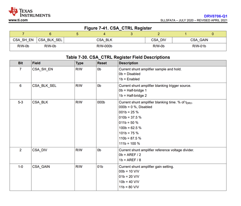

Currently trying to use the Current Sense Amplifier of the DRV8706S-Q1 for inline current measurement.
Are there any register settings that need to be done specifically for inline current sensing?

Hi Marcus,
Thank you for your question. Other than the standard CSA configuration - see below, there is no other specific settings for inline current sensing.
