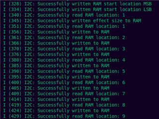

  • Currently, I am doing the following as a test. Please guide me on what could be wrong with it. The idea is to write to the RAM the header for the waveform and then the waveform, and verify increments to see if the effect is being written properly.

    And this is the output
    I am unsure of my understanding about the writes since when I write the effect size (configuration byte of the waveform), there is no increment in RAM. Is this expected behavior or is something wrong?
  • After the above, I am waking up the DRV2624 module and then setting GO bit to 1 to run the waveform. The sequence by default should be waveform index 1 at the beginning, and the rest zeroes. So, it should automatically stop after playing that waveform once.
    write_buffer[0] = 0x07;
        write_buffer[1] = 0b01001001;
        if (i2c_master_transmit(drv2624_handle, write_buffer, sizeof(write_buffer), 100) != ESP_OK)
            ESP_LOGE("I2C", "Failed to wake up DRV2624");
            return;
        ESP_LOGI("I2C", "Successfully woke up DRV2624");
        write_buffer[0] = 0x0c;
        write_buffer[1] = 1;
            ESP_LOGE("I2C", "Failed to write go bit");
            return;
        ESP_LOGI("I2C", "Successfully started effect");
    I don't see the motor moving at all when I do this, though.
