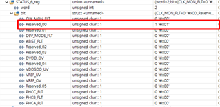

1) Fault occurrence in SPI communication

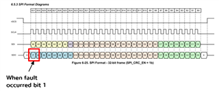

2) FAULT bit 1, SDO B31bit 1 of IC_STAT1 register (0x00h) when reading status register
3) No flag occurred when reading other status registers

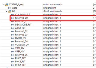

4) The bit corresponding to Reserved in IC_STAT6 is set to 1
Q. Why is the reserved bit set to 1?  Please tell me how to solve this.

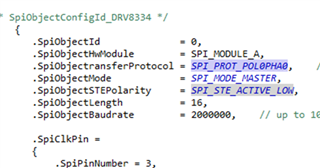

MCU : TMS320F2800156-Q1
MCU SPI option

    please make sure this bit is set according to the power supply for SDO
    Let me know if you need any additional help
    Yara

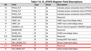

    What I am wondering is why the 'reserved' bit of IC_STAT6 is 1.
    Does this bit indicate a status other than 'reserved'?
    So DRV-8334 Q1 datasheet does not have MON_CTRL5.
    Why do I need to refer to non Q1 datasheet?
    Thank you
    Apologies for the confusion
    The Q1 datasheet is missing some of the registers (this is an error we are working to fix but shouldn't change the functionality of the device) while the non Q1 datasheet has all the correct registers included so for anything regarding SPI registers please refer to the non Q1 datasheet.
    Can you provide what is being written to the IC_CTRL2 register?
