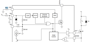

I have the following problem. When I close the valve using the EN pin, it takes about 1-1.5 seconds for the valve to close. What can I do to eliminate or reduce this delay?

What PWM frequency are you switching at?

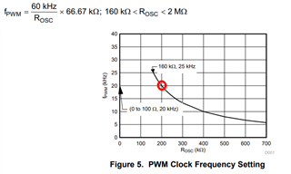

The ROSC resistor will set the oscillation frequency for PWM control. The frequency should have an effect on the delay between EN and gate drive.

Hello David, Thank you for your reply. The PWM frequency is set to 20 kHz using a 0 ohm resistor. What resistor value can I use to minimize the delay?

Hi Eugen,
In order to set the PWM frequency to 20kHz, the ROSC value will need to be increased to 200kΩ.

Hello David,
I replaced the DOSC with a 215 kOhm resistor, but this had no effect on the delay.
