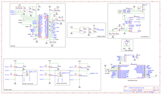

This is my schematic and layout:
Schematic
Does anyone know what could be the cause?

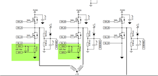

    This is how SPx and SNx pins are used. If you're wanting to use in-line current sense I believe the integrated CSAs do not support this, you would have to use external ones like this:

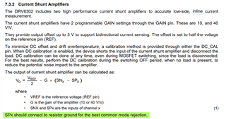

    I am also concerned about the missing low side current sense. The datasheet is not very clear about this, since only thing it states is this:
    It includes "inline current measurement", but does not state wheter or not does the IC need the sense resistors placed as shown in the picture you sent. Is it mandatory to connect the resistors between SN_X and SP_X like shown? Does the IC internally work with this somehow?
  • Hi Adam,
    In that same section 7.3.2 it mentions how SPx should connect to resistor ground
    I understand how the use of 'in-line' here can cause confusion but heres another example the datasheet provides for how SPx and SNx should be used:

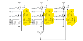

    I also have a small followup question about the sensing. What are these yellow marked components supposed to do in the circuit?Aren't they redundant when the current sensing is handled by the SN and SP pins? The typical application circuit says you should connect the X_SENSE pins to the MCU. So what are they reporting (also quite unclear from the sheet)?
  • Hi Adam,
    These circuits are dependent on your commutation method, for example they could be use for voltage sense when doing sensorless trapezoidal commutation to detect the 0 crossings.
