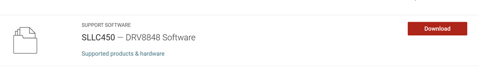

Hi Fabio,
Thanks for your post. Could you please share information about the type of motor, operating voltage, current and end application. Are you looking for stall detection? Is it BDC motor or stepper motor? The EVM software code can be downloaded from the EVM webpage, https://www.ti.com/tool/DRV8848EVM.
