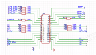

  • Hi Huan Yin,
    Are you using the EVM or your own design? If it is your own design can you share the schematic?
    When GHA outputs 12V what is the state of the INHA and INLA?
    When you say
    There is a 100Ω resistor between the SCK pin and the SCLK pin of the DRV8323
    do you mean between the MCU and the DRV?
    Yara
  • Hi,Yara
    I am using a custom-designed driver board, and the schematic diagram is attached.
    The MCU and DRV are connected via a DuPont cable.
    If there are any design issues with the schematic diagram, please let me know. This is very important to me.Thank you so much for your assistance.
    Best wishes,
    huan yin
  • Hi Huan,
    your schematic looks good, I dont really notice anything out of place.
    This is the point where you are using a dupoint cable correct to connect to the mcu?
    Are you connecting the MCU GND to the DRV GND? maybe there is a large GND difference that could be causing some SPI miscommunication to happen?
    Yara
