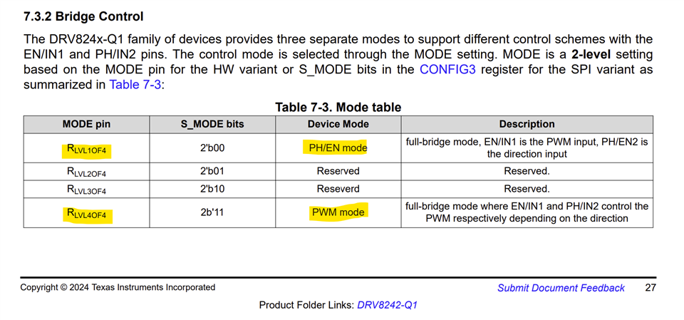

DRV8242H-Q1EVM: May I ask how the Mode Pin should be configured for the DRV8242H version
Part Number: DRV8242H-Q1EVM
  • Hi Bao,
    Thanks for your question.
    See below table and pin specification from the datasheet. MODE = GND will be PH/EN mode and MODE = floating / no connect / HiZ will be PWM mode. The datasheet is market for typo corrections for the next update cycle. Thank you.
    Regards, Murugavel
