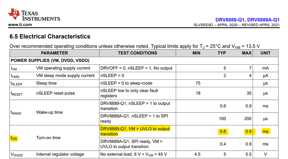

4. How long does it take to be ready to operate normally after VM is greater than 4.5V?
    See below specification in the datasheet. Thank you.
