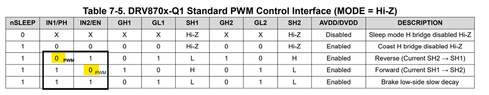

This depends on the MODE setting in this device. If MODE is set HiZ the device will operate in PWM control interface. See below table from the datasheet. I've highlighted the input controls. When both IN1 and IN2 are logic high the motor will not be running and will be in brake / low-side slow decay mode. This is the suggested mode while the motor is not running. In cases where output fully disabled and HiZ is desired both IN1 and IN2 can be logic 0, also known as coast where the motor will be free to spin.
For driving the motor with PWM in a specific direction one of the INx must be logic high and the other must be PWM input, 0 to 100 %, for speed control. The motor tON during the PWM will be when the PWM input is low, in other words the PWM input will be active low.

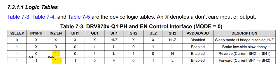

If the MODE = 0, the device will operate in PH/EN control interface. See below table from the datasheet. The EN input will accept PWM input, 0 to 100 %, for speed control and it will be active high logic in this mode. The PH input will be the direction DIR control. When it is high the motor will run in one direction and when it is low it will run in the opposite direction. In this mode when PWM input is low, the motor will be in brake / low-side slow decay. To render the output HiZ and allow coasting of the motor nSLEEP must be 0, logic low.
