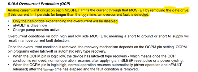

Dear TI expert
Please explain more thoroughly how the low-side MOS overcurrent is operated.

Hi Shaya,
Thank you for posting this question.
The internal details of overcurrent protection are TI proprietary protected information. The current flow through each MOSFET, low-side and high-side is continuously monitored and if any of these (including low-side for example an output OUTx shorted to VM supply) current exceeds IOCP for > tOCP an overcurrent is detected and the gate drive for both low-side and high-side FETs for that HBx are internally disabled. If you have a specific concern or question please let us know. We will try to clarify.
