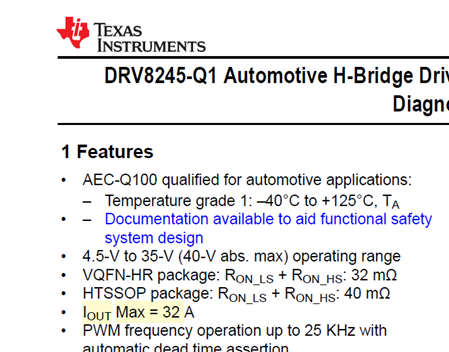

DRV8245-Q1’s Iout(max) is 32A, does it mean it can support 32A continues current for long time?

This item in the Features list is based on the minimum OCP current specification for the highest I_OCP setting. So this Feature is really describing the rated max pulse (time of ~6us) current the device can support.

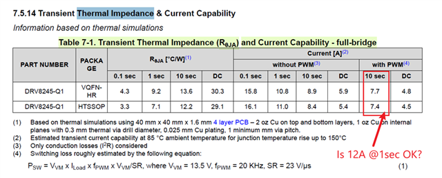

The max continuous current is more dependent on a couple of factors like ambient temp, slew rate, PWM frequency, copper area on the PCB. For a general guide we recommend looking at the Transient Thermal Impedance (RθJA) and Current Capability table (Table 7-1) in the datasheet. If the customer would like to analyze the temp rise based on thier load profile, they can use the Full Bridge Driver Junction Temperature Estimator.

Customer’s application needs support 12A @ 1 sec (with PWM) in some special situation.
I find it could support 7.7A @10 sec, could you help to evaluate if it can support 12A @ 1 sec (with PWM)?

The DRV8245-Q1 cannot support 12A at 1 second given the conditions listed below the Transient Thermal Impedance (RθJA) and Current Capability table . The max current that can be supported at 1 second would be close to 10A.
To support 12A at 1 second we would have to use the DRV8144-Q1 or the DRV8145-Q1. Both of these drivers are half-bridge drivers so two would be needed if a full bridge is required for the load.
