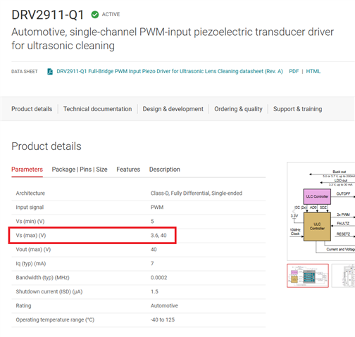

3-2. What is the meaning of Vs(max)(V) = 3.6, 40 in DRV2911-Q1 parameters? Why does it have 2 parameters?

    3-2. What is the meaning of Vs(max)(V) = 3.6, 40 in DRV2911-Q1 parameters? Why does it have 2 parameters? It is a typo. The max should be 40.
