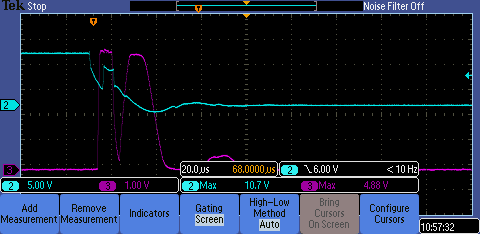

DRV3946-Q1: Current fault when using contactor with economizer
Part Number: DRV3946-Q1
Other Parts Discussed in Thread: TPS1HTC30-Q1

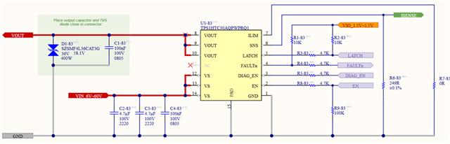

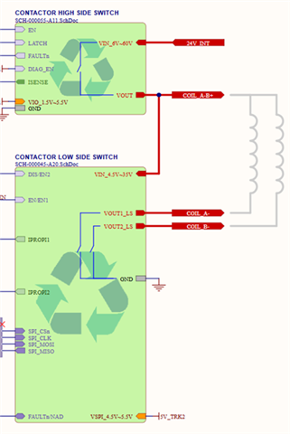

I am using the DRV3946-Q1 in an application with contactors that have a built in economizer.  I am seeing some weird behaviors where the driver IC gives an over-current error on the low side.
High side switch: TPS1HTC30-Q1
  • Always on during the test
  • FAULTn signal goes low for ~40us when the low side fault trips, but it self-recovers (it does not open the high side switch)
    • The LATCH is pulled high so expect a fault to latch the high side switch off and require toggling the LATCH to reenable -- but despite seeing FAULTn go low, don't see the switch turn off
  • The current measured on the high side switch at it's peak is 10.5A
  • The high side side switch over-current limit is expected to be 16A (R_ILIM = 0 Ohm to GND)
Low side switch: DRV3946-Q1
  • We've tried changing the peak and hold current limits to 2A hold, 4A peak up to their maximum setting 0xFF

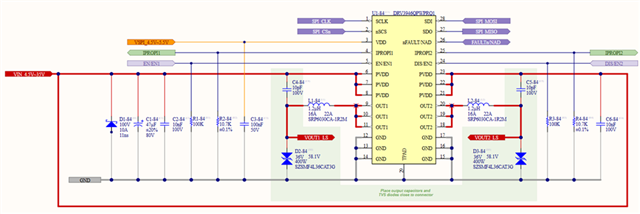

  • The IPROPIx resistors are 10.7kOhm
    • We have an external RC filter from this pin to our MCU for measuring analog voltage which is 4.7kOhm + 470nF
    • With this external RC filter, we found the DRV measured resistance to be 4.7kOhm
    • We tried adjusting or removing the external RC the DRV measures the expected resistance (10.7kOhm)
  • With the external RC on IPROPIx (DRV reported resistance = 4.7k), we occasionally get an over-current trip when driving a contactor with a built-in economizer
  • Without the external RC on IPROPIx (DRV reported resistance = 10.7k), we repeatedly get an over-current trip when driving a contactor with a built-in economizer
  • When trying on a contactor without an economizer the circuit works as expected
Is there a recommended configuration for the DRV3946-Q1 when using it with contactors which have an economizer?  Any ideas why having the DRV detect the correct resistance result in more over-current faults?  Why is the DRV reporting over-current at all if the measured current (measured on the high side switch) is < 11A?
Thank you for any help you can provide.
    - Is this coming from MEAS5 and MEAS6 registers?
    -Is there anything else connected on the pin other than 4.7k/47nF. It will be good to see a waveform of RIPROPI pin during power up.

  • Hi Ibinu,
    I am the firmware engineer working with Jess. Here are the answers to your questions, for context, we are trying to drive an EVC350 contactor (datasheet attached at the end of the post):

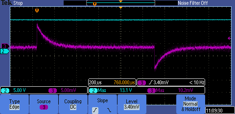

    1. The 4.7kΩ resistance we mentioned on the circuit with the RC filter is as read on the MEAS registers. At the moment, we have left the RC filter on the IPROPI1 pin and removed it on the IPROPI2, so the MEAS registers are:
      1. MEAS5 = 0xF911 -> ~4.7kΩ from datasheet page 13
      2. MEAS6 = 0xAD57 -> ~10.7kΩ from datasheet page 13
    2. There is nothing else connected to the IPROPI1 pin besides the RC circuit (as mentioned before, IPROPI2 is currently not connected to anything)

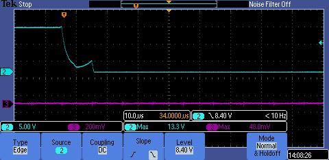

      Figure 1: IPROPI1 pin upon board power up
      Figure 2: IPROPI2 pin upon board power up

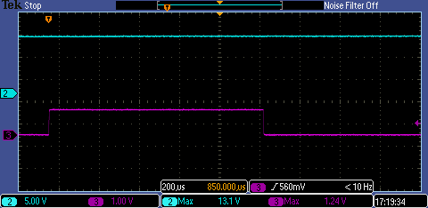

    3. When driving the contactor (with economizer) on channel 2, the STATUS registers are as follows:
      1. STATUS0 = 0x148B (Loss of control and OCP_LS error)
        1. This flips between the above and 0x1489 as the contactor is continuously closed and opened by the DRV3946
      2. STATUS1 = 0x3800
      3. STATUS2 = 0x0000
      4. STATUS3 = 0x0000
      5. STATUS4 = 0x0000
      6. STATUS5 = 0x0000

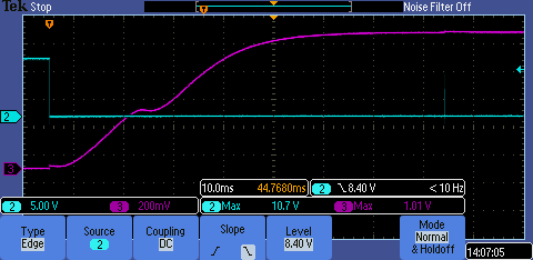

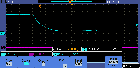

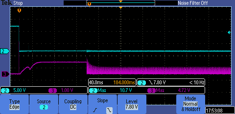

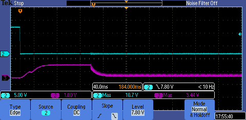

    4. Waveforms for contactor closing with economizer are in figures 3-5. This uses CH2
      Figure 3: DRV3946 CH2OUT and IPROPI2 Waveforms -- DRV Continuously Attempts to Close
      Figure 4: DRV3946 CH2OUT and IPROPI2 Waveforms Zoom to First Closing Attempt
      Figure 4: DRV3946 CH2OUT and IPROPI2 Waveforms Zoom to First Low Side Switch Closing
      Figure 5: DRV3946 CH2OUT and IPROPI2 Waveforms Zoom to First Low Side Switch Opening

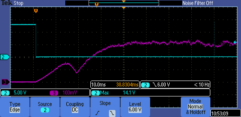

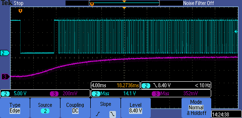

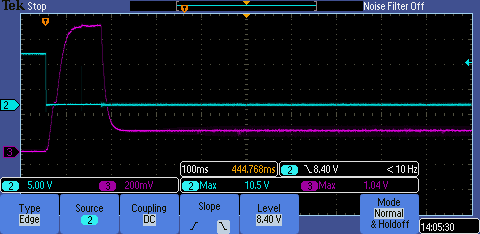

      Wave forms for contactor closing with economizer circuit manually bypassed are in figures 6-7. This uses CH2:
      Figure 6: DRV3946 CH2OUT and IPROPI2 Waveforms (No Economizer) -- Commanded Close through SPI
                     Note no PWM occurs later because of a high Hold Current configuration (see config at the end of post)
      Figure 7: DRV3946 CH2OUT and IPROPI2 Waveforms (No Economizer) Zoom to Low Side Switch Closing

  • Hello Marco,
    Thanks again for the detailed waveforms.

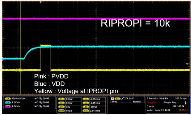

    During power up we measure the RIPORPI by forcing a current IPROPI pin and measuring against known thresholds, please see an example waveform below. From the waveform you shared it looks like  the RC waveform looks corrupted.
    However, I feel that the waveform without the RC is also not looking as per the expectation . Can you confirm that the signal is floating and not going to other pages in the schematic (like an MCU input etc)
    Ibinu
  • Hello ,

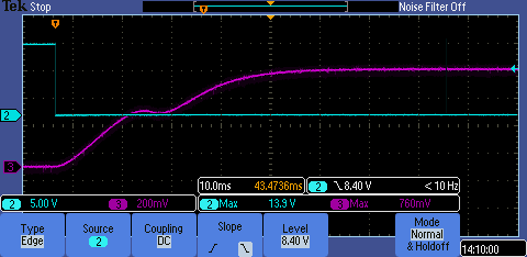

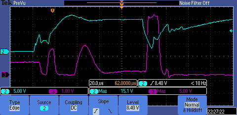

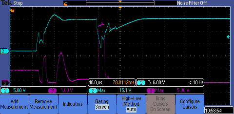

    Coming to the second problem, around 80ms looks like there is a high current and going into LSOCP.
    I went through the datasheet of contactor, but couldn't find out a reason.
    Also from the waveforms I understand that the waveforms that CH2 without the economizer was able to make the successful connection.
    For the end system are you planning to consider having the economizer? or will it be without that.
    Ibinu

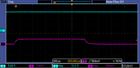

  • Hi Ibinu,

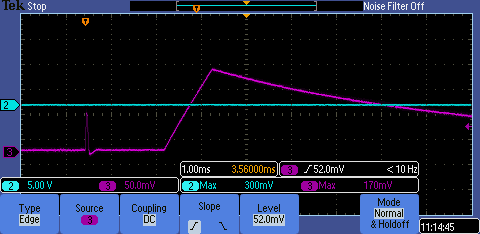

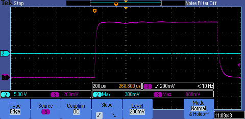

    It seems like I had some additional probes connected to the IPROPI pins when taking the board power up waveforms. I was able to retake those and got figure 1 for CH1 (contains RC filter) and figure 2 for CH2 (no filter). I verified the board layout and there is nothing else connected to the IPROPI pins.
    Figure 1: CH1 IPROPI Pin Measurement On Board Power Up
    Figure 2: CH2 IPROPI Pin Measurement On Board Power Up
    One thing I noticed is that the max voltage on the pin is not always the same for CH2. See Figure 3 and 4 for different captures of the board power up. Would these values be within the expectation?
    Figure 3: CH2 IPROPI Pin Measurement On Board Power Up - Vmax ~= 0.888V
    Figure 4: CH2 IPROPI Pin Measurement On Board Power Up - Vmax ~= 1.16V

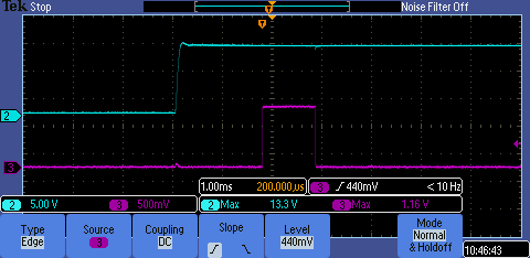

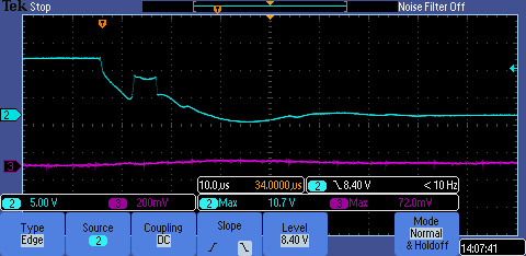

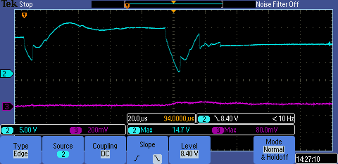

    Regarding the spike for CH2 on the contactor with economizer, I captured a close up of the event as shown in Figure 5 below. A similar waveform was captured in Figure 5 of my previous response.
    Figure 5: CH2 Overcurrent Event on Contactor with Economizer
    It would seem the voltage starts changing first, but I am not sure why the the contactor would be pulling more current in this case. Would you expect the DRV3946 to work as expected with an economized contactor? Do you have a recommended register configuration I can try on this setup?
    You are correct, I was able to get a contactor without economizer to close successfully using the same configuration. I simply opened the contactor and de-soldered the economizer circuit and connected directly to the coil for the test. Our nominal configuration will support a variety of economized (most common) and a few non-economized contactors from different vendors. We are trying to get a general configuration to work but we were surprised to see OCP errors on this economized contactor since we would have expected it to be easier to control. If you have a recommendation for the register configuration I would appreciate it.
    I have tried using the non-regulating mode at 100% duty but I would still get OCP errors.
    Thank you for your help, I look forward to your response.

  • Hello Marco,
    Thanks for the updated waveforms.
    From Fig 2 and 3 looks like the voltage is varying almost ~30%. This seems quiet high.  One follow-up here would be to look at the MEAS6 register and see if the register value is changing similarly. This would help us isolate if we have any measurement related issues.

  • Hello Marco,
    Adding on the second question.
    The interaction between economizer and DRV3946 will depend on the operation of economizer also.
    At the system level would the current regulation be done by economizer or DRV3946. DRV3946 has an option to do constant duty cycle if economizer is to be used for current regulation( please see the internal regulation disabled settings below).
    You can find more details on this in datasheet sections 6.3.5.2 Fixed Frequency, Variable Duty Cycle Mode and 6.3.5.3 Fixed Duty Cycle, Variable Frequency Mode.
    Ibinu

    • MEAS5:
      • RIPROPI: 0xBA
      • VIPROPI: 0x4C
    • MEAS6:
      • RIPROPI: 0xB8
      • VIPROPI: 0x4D
    Both of these measurements are within the range for the 10kΩ IPROPI resistance, according to section 5.5, p.13

    Waveforms for all channels are shown in Figures 3-8 below:
    Figure 3: Driver 1, CH1 Contactor Closing Waveform
    Figure 4: Driver 1, CH2 Contactor Closing Waveform
    Figure 5: Driver 2, CH1 Contactor Closing Waveform
    Figure 6: Driver 2, CH2 Contactor Closing Waveform
    Figure 7: Driver 3, CH1 Contactor Closing Waveform
    Figure 8: Driver 3, CH2 Contactor Closing Waveform
    As you can see on Figure 7 and 8, we get an OCP_LS (which I confirmed by looking at the STATUS0 register). In this case the initial spikes are of about 4.72V, which is the same as the spike for the Driver 1, CH2 (no RC filter), except that one managed to successfully close the contactor.
    Comparing the MEAS5 and MEAS6 for these two drivers, we see that they are both within the range for the 10kΩ IPROPI resistance, but Driver 1 CH2 measures 0xAE (174 decimal), while Driver 3 CH2 measures 0xB8 (184 decimal)
    We want to be able to successfully close the economized contactor as well as monitor the current that is being drawn (via the RC circuit to the ADC input). Is this something that would not be possible? Or do you maybe have a recommendation for RC values that we can try to be able to achieve both goals?
    It would be nice, if possible, to get a formula of how these MEAS5/6 resistance/voltage codes come into play when calculating the observed current and therefore the OCP_LS error trigger. Do you have a formula for Current Draw as a function of RIPROPI, AIPROPI, and the voltage measured at the IPROPI pin?
