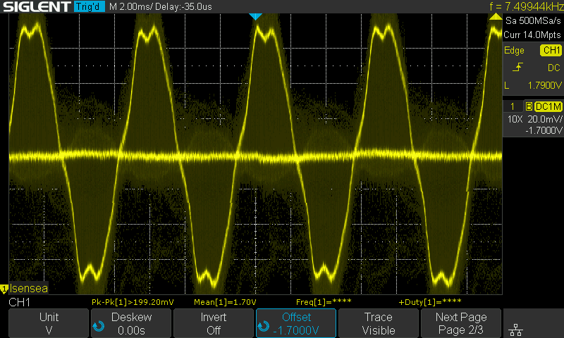

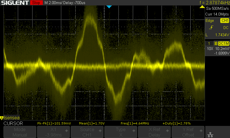

Phase A current (voltage drop across shunt resistor R4 for Phase A. amplified and sent out to the launchxl on ISENSEA pin) during identification of RampUp:
During Rated Flux:

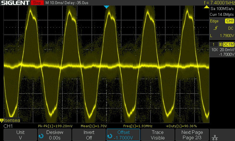

During Ls:
The last graph is closer to what I expect from a phase current for a bldc motor (looks close in MATLAB simulation for this hardware setup)

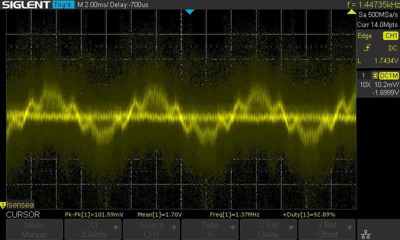

after identification and when running rough, the current looks as follows:

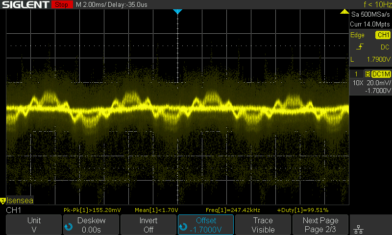

While it is smooth running after ID:
the last two graphs also apply to Lab 3b, when the motor runs with no identification.
I believe this issue cannot be a motor parameter issue (why would it run smoothly when moved/handled after identification?) so maybe it is a control loop (speed PI or torque PI) issue or an issue with the FAST estimator? I have checked connections.

    Do you think the phase current graph can give a clue? I expect a motor controlled with SVM to have a current waveform similar to the image shown here:, based on my very limited understanding
    Space Vector Modulation - MATLAB & Simulink
    But as you can see in the graphs I attached, when smooth running, the current graph does not at all look similar.
    Whereas during LS identification, it does. Why is this?

    Yes, I agree that the waveform should look like the 3rd image you included in your initial post. I'm not sure what exactly the code is doing between that image and the last, but maybe trying to keep track of the settings during that Ls section and trying to replicate the settings at that step after identification is complete could be a way to approach this.
