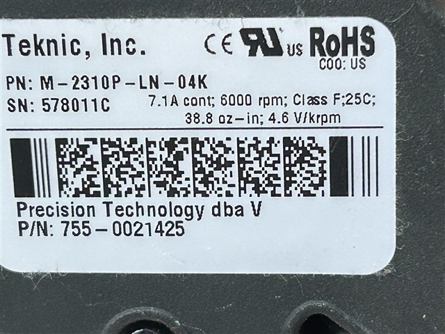

The motor I use is M-2310P-LN-04K(most TI's demo used)
More detail should be below one

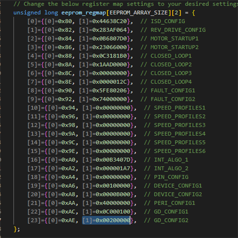

I get a parameter setting from previous colleague as below
And I make change of a json file that download from  the E2E FAQ 8. BLDC_Pump_3A_200Hz_MCF8329A_v1.json (can work upto 5A)
Replace the register from 0x80 ~0xAE with the value from previous colleague above picture.
So I get the a json file as this

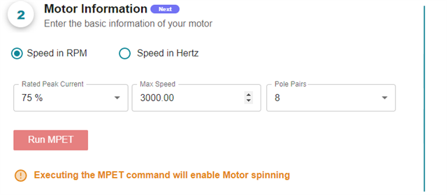

Load it at the step 1
Then I go to step 2
make change of the pole pairs to 8 and Run MPET

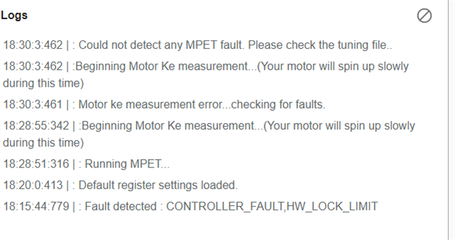

But the motor can't spin with the error below
What I missing there? Please guide me, thanks

    MCF8329 EVM with 1mohm shunt may be too low resolution for the motor without load, if you load it for 5A then it makes sense.
    Do not set current threshold so high, check controller fault setting for thresholds.

    So you recommend me to change the shunt resistor to 10mohm?
    Do you mean the HW_LOCK_ILIMIT and LOCK_ILIMIT? I have try to set them as 80% and 75%.
