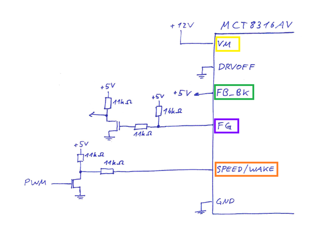

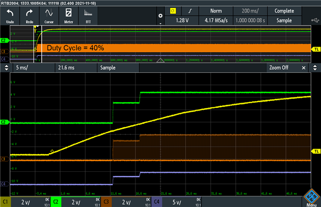

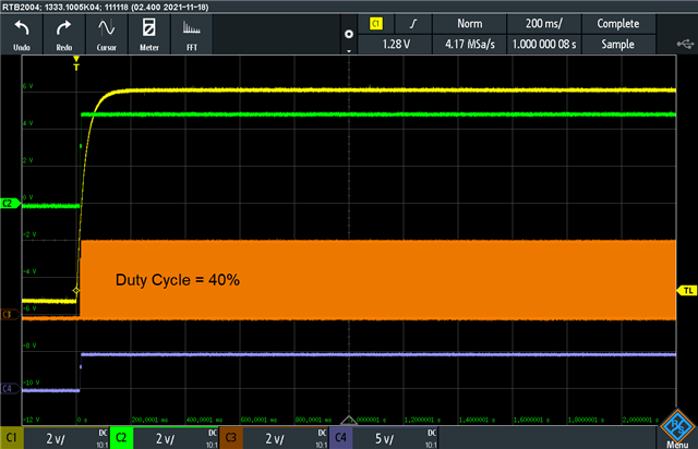

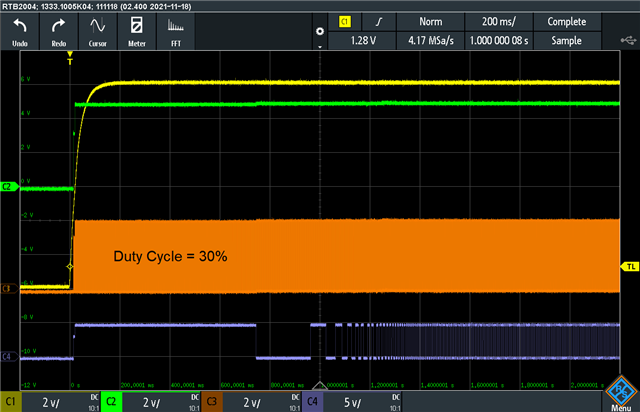

    Please find attached pictures: Schematic and screenshots during power on with duty cycle 30% and 40% (sorry, the probes were not calibrated well). Maybe this pictures will help you.
    Brest regards, Emanuel
    Duty Cycle = 30%
    Duty Cycle = 30% (Zoom)
    Duty Cycle = 40%
    Duty Cycle = 40% (Zoom)

    Thanks for reminding, I looked at the details but not able to find the reason.
    We need some more probing to root cause,
    Can we test with following condition
    1. By reconfiguring FB_BK level to BUCK 3.3V in the EEPROM? For 5V, VM has to be stable above 6V and racing under high demand start can cause some disturbance.
    2. Capture same waveform for 25%, we will compare how VM is compared with higher duty. The high duty start can be loading VM source.
    Make sure hardwire of DRV is proper and no floating or pick up issues.
    Can you share full schematic and JSON file?

    Unfortunately, I cannot provide full shematic (that's why I draw the relevant schematic by hands, the MOSFETs are 2N7002*), but the voltage signals at the pins are shown in the screenshots. The 5V is generated with a 22uH inductor. The 5V doesn't drive other loads than shown in the hand drawn schematic).
