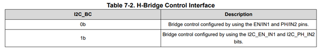

The DRV8215 contains PWM and PH/EN modes along with an I2C interface. The device can be controlled by hardware through GPIO or using i2C interface. The PMODE bit in I2C registers allows to control the H-bridge solely through I2C commands, reducing the number of GPIO inputs.
The I2C_BC bit determines whether the bridge is controlled by the EN/IN1 and PH/IN2 pins or the I2C_EN_IN1 and I2C_PH_IN2 bits, as shown below.

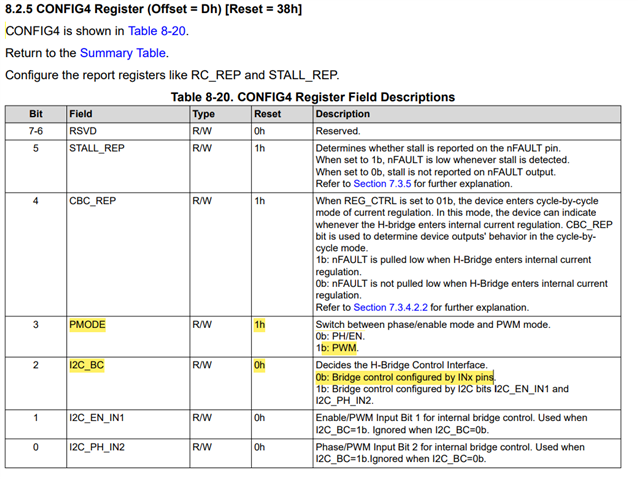

The control mode is selected by the PMODE bit. DRV8215 allows users to choose either Phase-Enable mode or PWM mode, as described below.
CONFIG4 sets the I2C_BC and PMODE default value. The Default value for I2C_BC is 0h which configures the HBRIDGE control by INx pins. and also, the default PMODE is 1h which enable the PWM mode.
