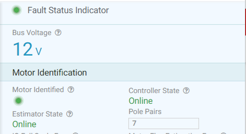

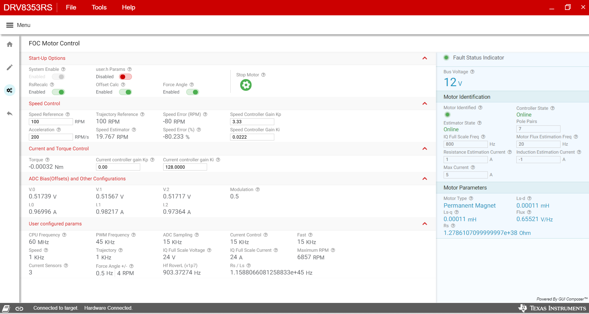

We are facing similar issue where the motor gets identified but not spinning, We tried two different motors, Both did not work.
The attached screenshot is of 920KV Brushless DC Motor. Motor has 14 magnets, so we have entered 7 poles.

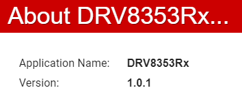

Software version:
switch settings at default:
To check if EVM is working we disconnected the BLDC and started the process ,observed motor identification was green and  motor control /estimator state was also green. Not sure how motor was identified even after BLDC was disconnected.
Please advice how to troubleshoot this problem.
    The motor identification process should still be able to run even without the motor connected. It will just populate with incorrect parameters.

    In GUI there are no errors, But red fault led gets on EVM.
    1) As per your instructions we tried to change and update registers but values are not updating.
    2) We have set voltage to 12v and 5 amp so there is more than enough power to make the BLDC spin.

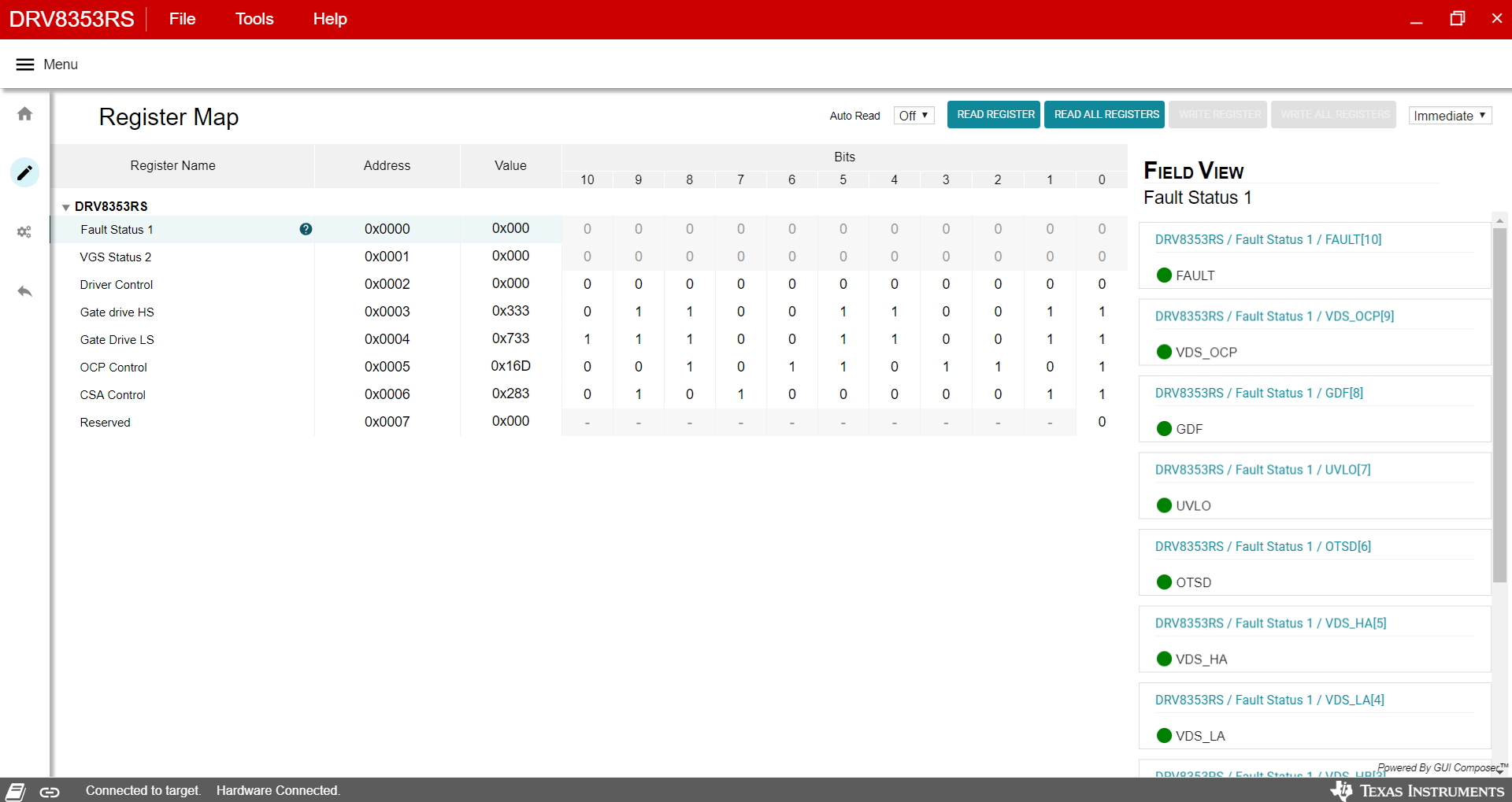

    When you encounter the fault, do any of the values in registers 0x00 or 0x01 change? I know the GUI light does not change, but do any of the fault register values update?

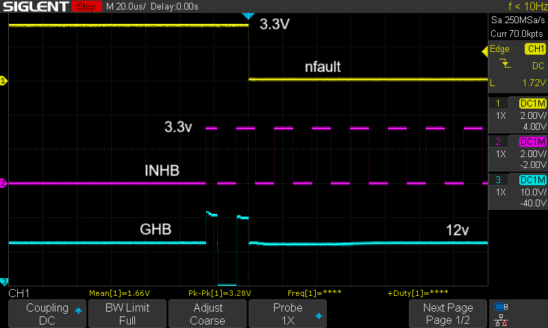

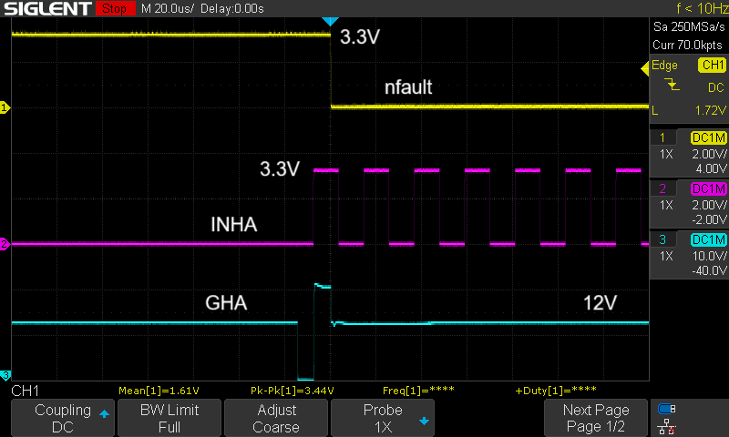

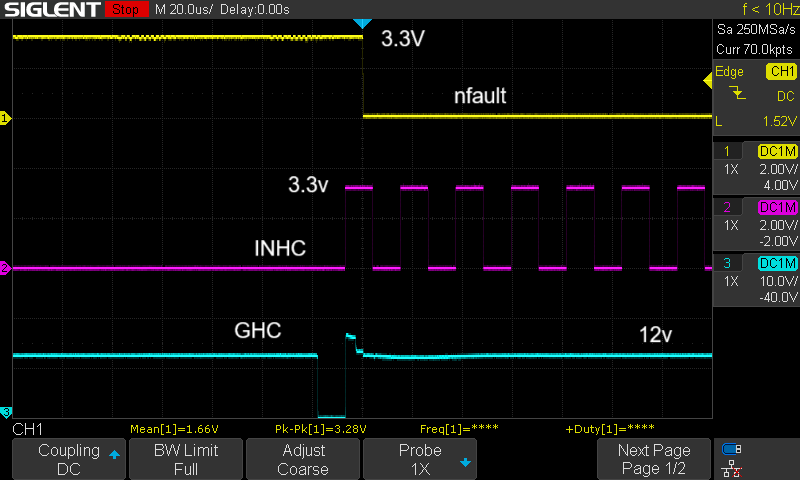

    The other thing we can check now is the waveforms during operation to get clues about the issue.
    Can you probe INHx, GHx, SHx and nFAULT on the scope and trigger on falling edge of nFAULT?

  • Hi Joseph,
    No registers 0x00 or 0x01 do not change
  • Hi Renu,
    Just making sure you click read all registers button after fault occurs. You have auto-read setting off, so the registers will only update if you change that setting or if you hit the read all button.
    If you have done this and the registers still do not show anything we can continue debugging.

  • Hi, Joseph
