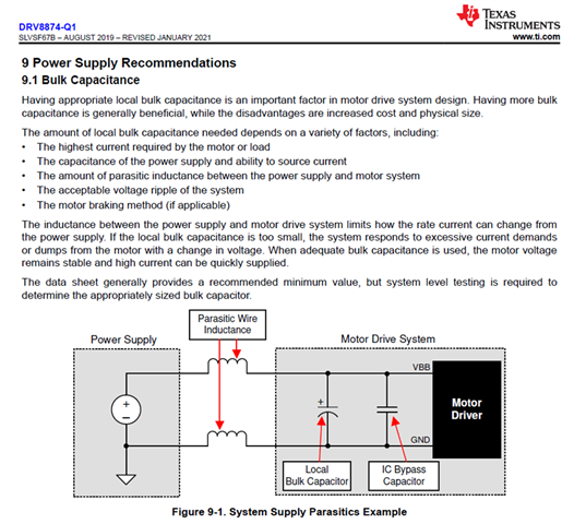

Hi Expert,
Have a nice day! I have question need your professional support:
About Cbulk, datasheet provides some advices about how to choose it.
My question is could you give some recommended value of this Bulk Capacitance based on the application scenario:
 VIN: 13.5-16V, Iout Max: 3.8A
Thanks!
