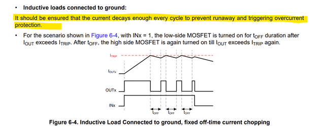

    All of those applications are possible with the DRV8962. See datasheet section Application and Implementation. While driving DC motors the DRV8962 behavior will be different compared to the DRV8262 because the current chopping is done differently - see datasheet section Current Sensing and Regulation. Current recirculation during tOFF is different for these two devices. For BDC motor and Stepper motor the DRV8262 will be better suited vs. the DRV8962 may not be able to have proper current regulation with low inductance and low DCR BDC or Stepper motors because of the tOFF architecture differences. It is mentioned in the DRV8962 datasheet - see below. This limitation is not there for the DRV8262 because of the difference in tOFF architecture.
