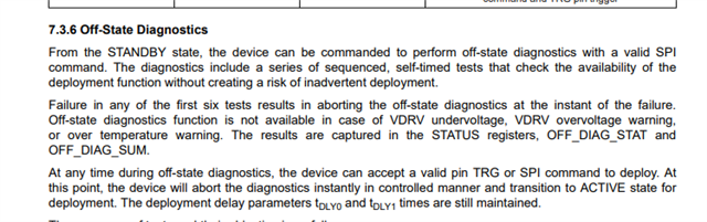

I would have a question regarding DRV3901-Q1 off-state diagnostic sequence. Does it require a disabling of TRG 1 & 2 pins in order to avoid false deployment of the pyrofuse?
In case TRG pins are not disabled and there is a trigger sequence requested while in off-state diagnostic will the deployment be executed and the diagnostic aborted?
