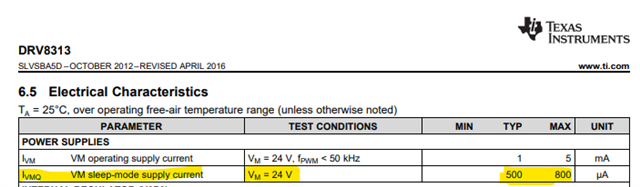

    The first thing to note is that 3V on VM is well below the recommended operating range minimum of 8V.
    As for the sleep current, our datasheet specs this value at 500-800uA, which was tested at a VM value of 24V.
    What is the 20-60nA vale you are referencing from the datasheet?

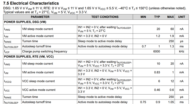

  • I'm sorry, I put the wrong part number it is the DRV8213
    We are using the RTE variant so technically it is 10-20nA

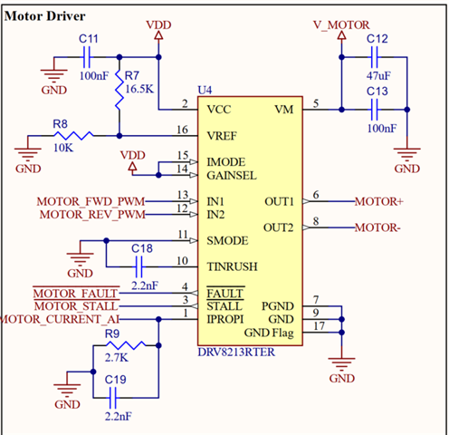

  • Thank you for the quick reply Joseph.
    Unfortunately, I am not able to share the full schematic, but I can attach a screenshot of the motor driver configuration, only the MCU and the motor driver are powered.
    The current consumption on the MCU is 3.52uA when the motor driver is powered completely off.
    Once the power is supplied to the motor driver and after the tAUTOSLEEP  it goes to about ~95uA.
    If I remove power from VREF, IMODE and GAINSEL it drops to around 20uA.
    Please note that R7 and R8 have been changed to 1.8MOhm and 1.2Mohm respectively.

  • Hi Ivaylo,
    The split supplies for the DRV8213 RTE package allow the VCC to supply to keep the internal logic awake while VM drops to 0V.
    "In the RTE package, when VVCC < VVM, the DRV8213 draws active current from the VM pin rather than the VCC pin (IVM). During this operating condition, IVCC is typically less than 500 nA. When VVCC > VVM, the device draws active current from the VCC pin, and the VM pin will only draw current required by the load. When VVCC = VVM, the active current may be drawn from either supply pin. The active current is typically less than 1.9 mA."
    If possible, could you try increasing VM above 3V (maybe 5V) and see if this improves the sleep current value?

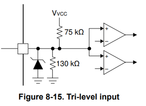

  • Hi Ivaylo,
    This makes sense as the VREF, IMODE, and GAINSEL pins share a similar internal structure.
    Because they are being pulled up to VVCC=3V then seeing this increase in current draw would make sense. Powering directly from the MCU would help to keep the sleep current lower.
