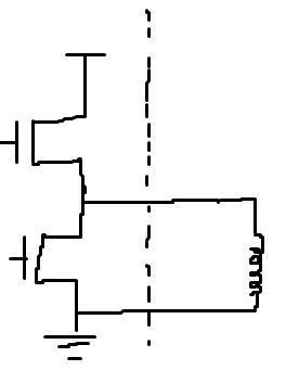

    In the case where I am just using a single channel as a half H bridge and controlling a solenoid with PWM like the following:
    If i want the low side FET to be turned on during the "off" cycle to allow the recirculation current to not have to flow back through the body diode of the low side FET then that would be using the "slow decay" mode defined in section 7.4, correct? There may or may not be a separate flyback diode in parallel with the solenoid.
    Yes, this is correct. You want to use INx as PWM input, ENx = 1 just so during PWM input off time the LS-FET is turned on and provide a low impedance path for the recirculation current. There will be a very small gap though. There will be a dead time of 300 ns to avoid shoot through current damage of the FETs during transition between HS_FET off and LS-FET on. During this 300 ns, the recirculation current path would be via the body diode of the LS-FET or an external flyback diode if it had lower VF compared to the body diode, such as a Schottky diode - sometimes these are integrated with the solenoid itself.
