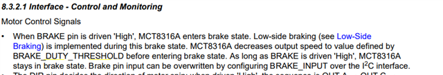

1、When using BRAKE pin brakes, is the current controllable, and if so, through which register?
2、What current does the Brake Current Threshold control? What is the relationship between voltage and current? In which case does it work?
3、Does the Brake Time register still work when using the Brake pin brake? Or does the Brake Time register work in that case?
    NO, Brake current depends on the motor speed, bemf. The brake enabled all low side FET which causes BEMF to regenerate current , the magnitude depends on motor energy.

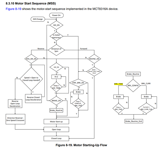

    If current based brake is selected through Brake Mode, brake routine exits when the recirculation current on the phase drops below the configured threshold. Brake routine works when start command issued or brake is commanded through pin
    Brake pin applies brake always as long as pin is high.
    Please refer to the startup sequence as when brake routing follows time.

  • If I want to control the current of the motor less than 5A when braking with BRAKE, what should I do?
  • Hi Sunny,
    You can use BRAKE_DUTY_THRESHOLD value, this decelerates motor to safe speed before applying brake.
    At reduced speed brake current will be limited.
