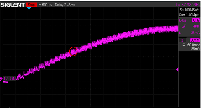

Set PPS: 200
Microstep: 32
Current: 200mA

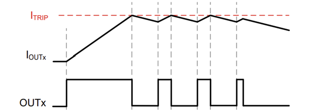

1. Testing the output terminal AOUUT+ and observing the output current, I found that the waveform shows individual bars at each step (as shown in the red box). What causes this phenomenon? How can I explain this phenomenon?
2. While the motor is running, I intentionally stalled it. Observing the output voltage and current, there are no abnormalities. How can I explain this?
3. How can I detect when the motor stalls due to resistance during operation? Besides the stall detection method, are there any other parameters that can be used as indicators?
  • Hi Hung,
    Thanks for your question.
    This is normal expected waveform. For each step / microstep the current level is regulated using tON and tOFF chopping. This causes the small ripple at the chopping frequency at the microstep current level. If you zoom in further you'll observe multiple tON and tOFF chopping cycles within a microstep.

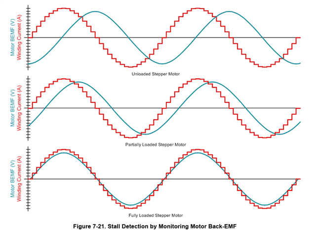

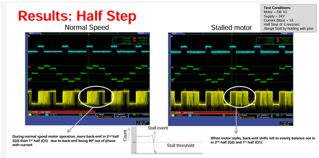

                1.Regarding the back EMF measured in the figure below, how do we know that Q2 and Q1 are in balance? And how do we know that Q2's back EMF                 is  greater than Q1's?
                2.Is the back-EMF test method a standard test method?
  • Hi Hung,
    The BEMF will be a sinewave represented as a blue trace in the below image snippet. In a stepper motor the BEMF has a distinct relationship in phase difference with the corresponding coil current waveform. This phase difference is also known as load angle. The load angle indirectly represents the load torque on the motor. This is a property of stepper motors. The DRV8889-Q1 stall detection uses this property to detect a motor stall.
    Please refer to section 4.1 Algorithm Details of the application note. We use the TOFF measurements during these quadrants to get a measure of the load angle, hence torque count. Thank you.

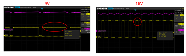

    1. I've adjusted the input voltage to 9V and 16V, or increased the input current, and have noticed that when measuring the voltage relative to ground on the AOUT A channel, these changes affect the turn-on time (as shown in the red box below). Could you explain this principle?
  • Hi Hung,
    Sure!
    This is due to the current through the coil L and R series circuit and its time constant and the supply voltage. With supply voltage for the driver as VM the steady state DC current through the coil with resistance R would be (VM/R) and when the coil is switched on the current in the coil will rise (tON) based on this steady state current, the L/R time constant Τ and Itrip current level set by the VREF voltage.
    Using the formula from electrical circuit theory for current through an inductor with time constant L/R, which can be found in the internet or electrical circuits text books the time tON can be calculated. I'm copying it here (see below formula) for your convenience. Substitute V by VM, R resistance of stepper, I the Itrip current setting, t is tON and Τ is the time constant of the motor coil (L/R). Using this formula, you can see when VM is increased tON will decrease and vice versa.
    Formula:
    The current (I) as a function of time (t) during charging is given by: I = (V/R)(1 - e^(-t/τ)).

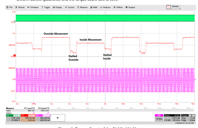

                 1.How do we measure and verify the following curve?

    I assume your question is about stall detection and you want to understand how BEMF is measured to detect stall, correct? We use smart tune ripple control decay mode which provides variable tOFF which has a relationship with BEMF voltage. This is described in this application note, https://www.ti.com/lit/an/slvaei3/slvaei3.pdf.
