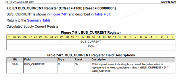

        1.The variable I want to monitor is Bus Current. Is the Base Current in MCF8316C 10A? So, 1 pu = 10A (dac output = 3V); However, the voltage output by the current DAC does not match the value of the Bus Current;
         (a)Dac Out 1 Volt = 1.39V;
        The Reg of bus current(0x410) = 773863, iBus = (773863/2^27)*BaseCurrent(10A)/8=0.00720A, Scalling=(2^2=4)Therefore, the theoretical calculated value of dac_out = 0.00720 * 3V * 4 =  0.08648V,which is ≠ 1.39V;
         (b)
     Dac Out 1 Volt = 0.900V;
        The Reg of bus current(0x410) = 2190792, iBus = (2190792/2^27)*BaseCurrent(10A)/8=0.0103A, Scalling=(2^2=4)Therefore, the theoretical calculated value of dac_out = 0.0103* 3V * 4 =  0.124V,which is ≠ 0.900V;
         (c)
     Dac Out 1 Volt = 0.118V;
        The Reg of bus current(0x410) = 1112346, iBus = (1112346/2^27)*BaseCurrent(10A)/8=0.020403A, Scalling=(2^2=4)Therefore, the theoretical calculated value of dac_out = 0.020403* 3V * 4 =  0.244V,which is ≠ 0.118V;
          2. I haven't found a linear relationship between the actual output voltage of the DAC out and the Bus current. But I'm not sure what the reason is. Do you have any suggestions?

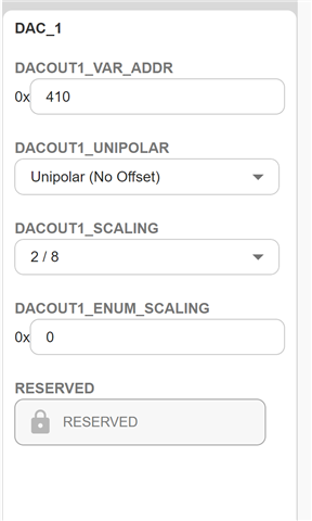

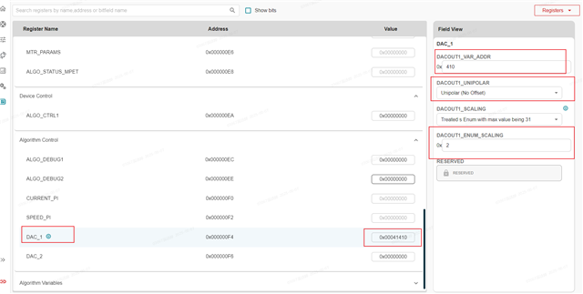

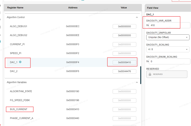

  • Hi John,
    I observe you have used ENUM scaling which is wrong.
    You the setting like shown below
    Equation is
    Actual Value= ((DAC Voltage*Base Value) )/((3* DACOUT1_SCALING))
    Where,
    Actual Value is Bus current in absolute value
    Base Value is Base current, it is 10/8 for MCF8316C and 6.25/8 for MCF8315C
    DACOUT1_SCALING is 1/8,2/8,3/8,...15/8 one of them.
    For currents recommended DACOUT1_SCALING is 2/8, for Voltages 8/8 and for Speed 7/8.
    Thanks and Best regards
    Venkatadri S
  • Hi Venkatadri,
        Get it.DAC output 1 has successfully mapped the Bus Current.Thank you for your help.

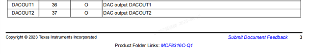

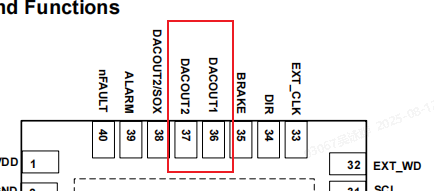

       Another Question:In the datasheet, dac out 1 corresponds to Pin 36, and dacout 2 corresponds to Pin 37.
    But in fact, the dac out 1 output is on Pin 37, and the dac out 2 output is on Pin 36,which is different from datasheet(MCF8316C Q1).Is this a writing error in the datasheet?

  • HI Venkatadri,
              The chip used is MCF8316C. I tested three PCBA boards(Not Ti EVM) and the results were the same each time. I configured Dac out 1 to monitor the bus current, but in fact, it was outputting from Pin 37,,which is different from datasheet(MCF8316C Q1).Is this a writing error in the datasheet.
            Any idea?Could this be caused by the configuration on our software?Here is our  configure/cfs-file/__key/communityserver-discussions-components-files/38/1881.M0M2_5F00_DACOUT1_5F00_register_5F00_0812.zip

  • Hi John,
    This is error, DACOUT1 is on Pin 37 on MCF8316C, we will be updating the documents.
