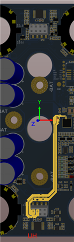

    3) Just to confirm the damage always occurs on Phase A? Is this the phase farthest from the driver on your layout?

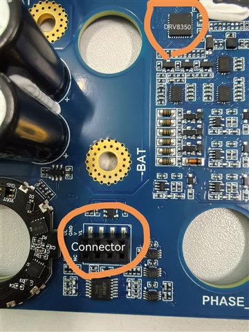

    ----Yes, pls see the PCB in attechment.

    4.mosfet is in the other power board,and connected with the connector in the main board.
  • add a point: only DRV8350 damaged and mosfet is good.

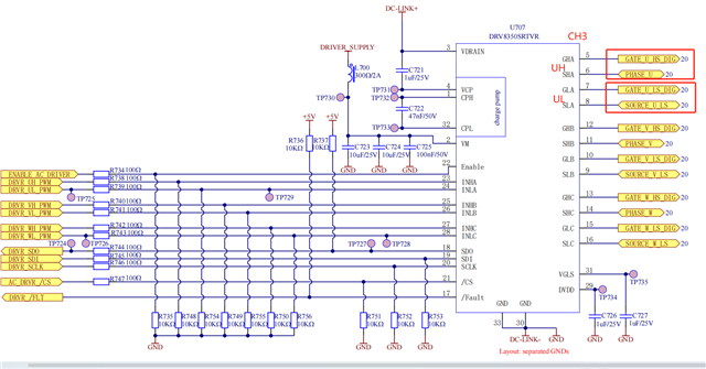

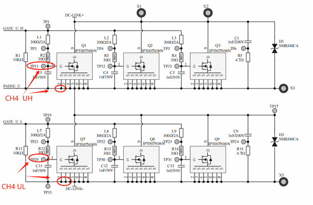

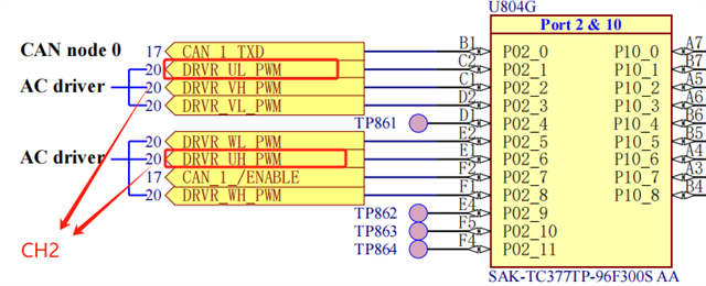

    Could you tell me what the following signals are:
    CH2: TC377 output driver
    CH3: DRV8350 output driver
    CH4: MOSFET gate PIN signal
    For the waveforms I requested please take them as close to the driver pin with respect to driver ground. As if the signals is taken near the MOSFET,  capacitance of the MOS can affect the signal and smooth it out. We are concerned with driver abs max violations.

  • Hey Jon,
    This document seems the same as earlier one, what was the update?
    My questions/clarification need was
    1) what is the TC377 output driver on the schematic
    2) DRV8350 output driver (is that GHx-shx or , SHx-gnd?)
    3) what is mosfet gate pin signal (GHz-shx at mosfet? glx-gnd at mosfet?)
    This is why I was requesting the specific signals combinations I mentioned in my earlier post being measured at the driver pin to see if we see any abs max violation. Also I dont think Shx-gnd is shown as I dont see a signal at 24V in the existing waveforms
    Please let me know if i missed anything.
    Akshay
  • Akshay,
      Please refer to the indicates in the picture.Thanks.
  • Hey Jon,
    Thanks for the clarification for ch1, and ch2.
    Where is Channel 3?

  • Akshay,
         pls see the picture of Channel 3.
         Because lower Idrive/gate resistor will increase switch losses,and the switch losses now is higher than the target,so can't reduce the Idrive/gate.
         TI Local FAE stone suggest removing the 1nF capacitor and magnetic beads from the Mosfet gate. The customer found that after removing this 1nF capacitor, it ran for 30 hours without any further problems. The customer inquired whether removing this capacitor would have any other adverse effects? Is this plan feasible? Thanks
  • Hey Jon,
    Where is the ferrite bead placed?
    let me check with the team as well.
    Akshay
  • Hey Jon,
    I would need the waveforms I requested to better understand the situation. Also how many units were tested after removing the ferrite bead and the VGS cap?
    Do we have gate, source waveforms before and after removing the cap and bead?
    Where is the ferrite bead placed? Also if we change two items it is hard to tell which specific change led to the improvement.
    Please help clarify, thanks!
