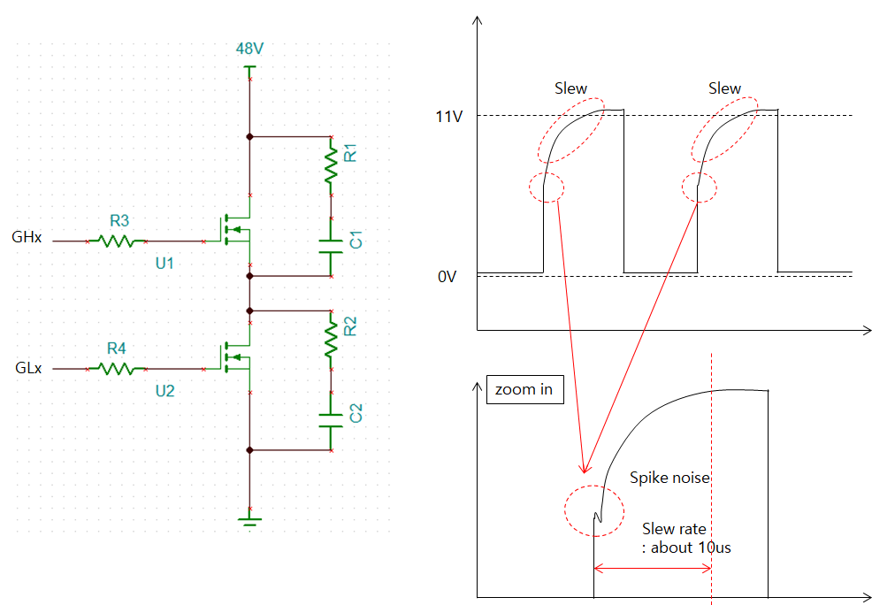

We have configured the MOSFETs for driving a 3-phase motor as shown below, and we are applying a snubber circuit.
First, we measured the VGS of the high-side MOSFET using a differential probe, and the measured waveform is attached.

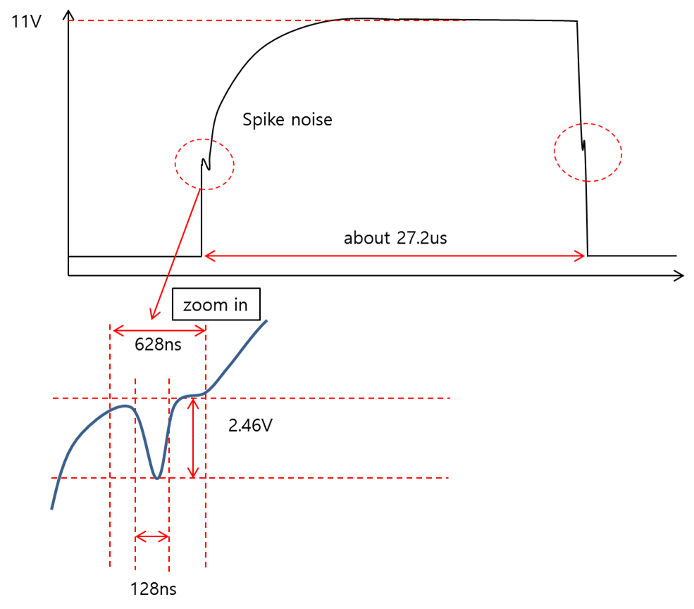

  1. The VGS (GHx) waveform of the high-side MOSFET appears to be a square wave, but the positive edge section shows a slight slew rate. However, the VGS (GLx) of the low-side MOSFET is a perfect square wave with no slew rate.
    We would like to know if it is normal for only the high-side MOSFET’s VGS (GHx) waveform to have a slight slew rate in the positive edge section, and why this slew region occurs.
  2. When zooming in on the positive edge section of the high-side MOSFET’s VGS (GHx) waveform (which has the slew rate), we observe a small spark-like noise.
    We would like to know possible methods to eliminate this phenomenon, the reasons why it occurs, and what side effects it may cause if it persists. (IDRIVE PIN : SHORT TO GND (Minimum setting))
  3. R3, R4 = 1ohm / R1, R2 = 3ohm / C1, C2 = 470pF

    1. The VGS (GHx) waveform of the high-side MOSFET appears to be a square wave, but the positive edge section shows a slight slew rate. However, the VGS (GLx) of the low-side MOSFET is a perfect square wave with no slew rate. We would like to know if it is normal for only the high-side MOSFET’s VGS (GHx) waveform to have a slight slew rate in the positive edge section, and why this slew region occurs.
    A - Both High side and low side VGS voltage will have a slew during turn on and turn off. Is highside being measured from GHx-SHx and low side from GLx-GND? The time scale might be affecting how much the slew is being visible. The gate current will determine how fast the MOSFET slews up.
    What is the rise/fall time for VDS?
    A - This looks like noise around the miller region of the MOSFET. This is the region where the MOSFET VDS is slewing. Can you take waveforms of GHx-GND, SHx-GND, and VGS for a rise and fall? There might be switching noise on SHX, which could be coupling into the VGS voltage.

    1. I measured VGS as GHX-SHX and GLX-GND.

    1. This waveform is a hand-drawn representation of the actual waveform. Due to the firewall, I am unable to attach the real captured waveform. I tried to draw it as closely as possible, and I kindly ask for your understanding on this.
      Our control frequency is about 20 kHz, and we are performing current control.
      We measured GHx–SHx and GLx–GND on the oscilloscope with the same time scale, and only GHx–SHx shows the slew rate, similar to the waveform I previously shared.
      GLx–GND, on the other hand, is almost a perfect square wave.
    2. Please refer to the attached waveform diagram.

    As far as the noise you see on GHx-Shx - The noise seems to be located around your miller plateau voltage. Miller Plateau is where VDS slew of the MOSFET occurs, this is where you have a voltage rail going from 0-48V this noise can couple into the miller region based on layout/parasitic capacitance present. To reduce the magnitude you can try to slow down the slew rate using lower gate current. (fast switching applications target around 200ns for VDS slew.
