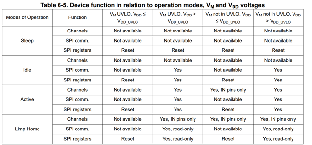

  • 1. When nSLEEP low, and device turns into limp home mode, will the limp home IN1 map to OUT3 immediately?
    • Yes in limp home mode, IN1 gets mapped to Channel 3 (default)
    2. What is the delay time between enter limp home and OUT can output with limp home(IN1)?
    • Is there a requirement that they are trying to meet?
    • Once in limp home, they will be able to output there is no additional time
    3. What is the priority between INx and register/SPI at limp home mode? Are then OR relationship
    • SPI is read only in limp home
    • Please see table summarizing operation modes:
