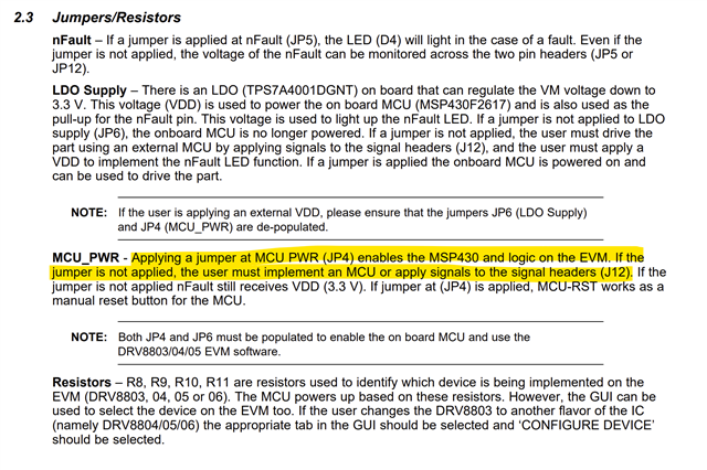

Hi Murugavel,
seems as though it is possible to run the device in full-step or half-step unipolar mode
and then control the device with two input pins for STEP & DIR.
If this is the case then maybe no need for the GUI ?
Daria
Hi Daria,
Yes, you are correct. There is an MSP430 MCU on the EVM which generates these inputs to the DRV8805 driver based on the GUI settings. See EVM UG - below snippet. The device can be used with external inputs without using the GUI as well. Thank you.
Regards, Murugavel
