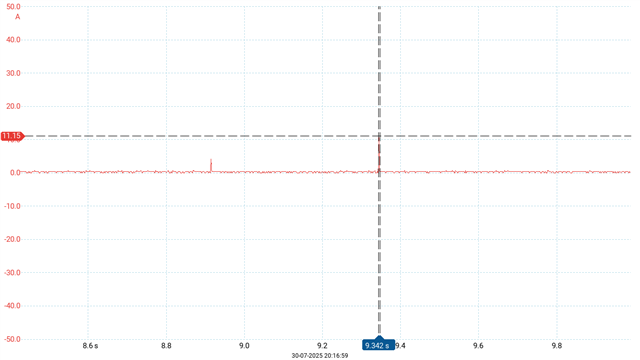

    The below given is the test:
    The idea is to experiment the fault situation where the GND terminal is connected to output terminal instead of ground pin. The reference ground will be floating and the output terminal will be connected to the ground. The current wave form drawn from the battery is given below. The current peak is 13A and the pulse duration is 3ms.
    Hope this will help you.

  • Hi Jishnu,
    I tested this on bench, and I believe the large current draw was likely from the bulk capacitance on VM. Was this test done on a DRV8876EVM?

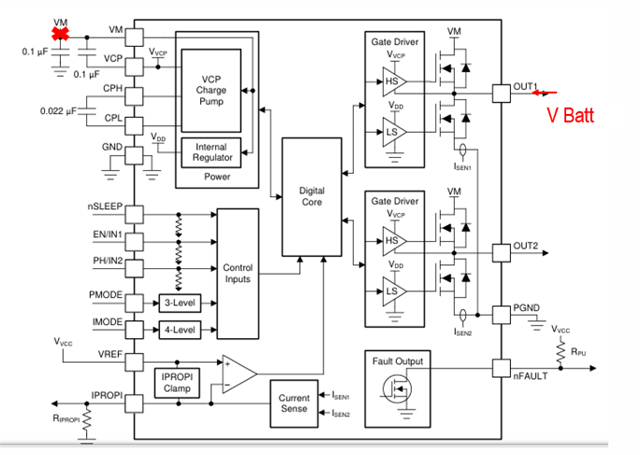

  • Hello Joshua,
    Thank you for the response.
    I did this experiment on a PCB made with my specification. Unfortunately, on some IC it is leading to the failure condition.
     Apart from this there is another test where the GND is connected and applying the VDC at the OUT1 (Similiar, but the VM is floating). This creating a backward current path, which I didn't expect due to because of the internal MOSFET diode. This is create a voltage at my power line which is connected to the other circuit and the operation of those circuits draws the current through the IC. This is leading to instant failure of the circuit.
    I really appreciate if you can look into this situation, If it possible recommend some protection scheme from this kind of faults.

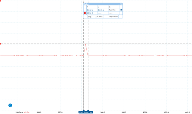

  • Hi Jishnu,
    1. Can a zoomed in capture of the 13A peak pulse be provided?
    2. Can a capture of the VM voltage and device GND voltage (so PGND and/or GND pins) be provided? We are looking to see how much the GND of the device is jumping during this event
    Joshua
  • Hello Joshua,
    Please find the response for your queries:
    1.Can a zoomed in capture of the 13A peak pulse be provided?
    The above figure shows a current pulse during that event. It is observed that the value is 10A for a duration of 4ms when it failed.

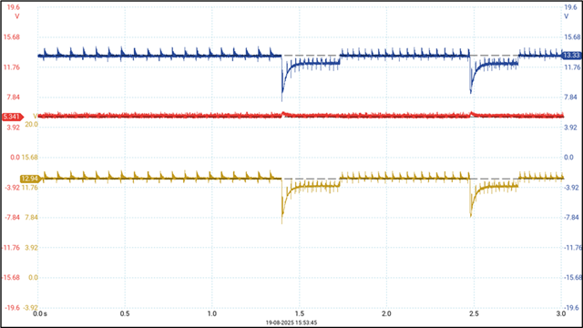

    2. Can a capture of the VM voltage and device GND voltage (so PGND and/or GND pins) be provided? We are looking to see how much the GND of the device is jumping during this event.
    I'm attaching the waveforms during the experiment when the Vdc is connected to the OUTPUT of DRV8876  and ground is connected . The voltages at different terminals are taken as shown below.
    The voltages are probed at VM(blue waveform), across charge pump(red waveform) and the main power line(yellow) which are connected to the other circuit
    Hope this will help.

  • Hi Jishnu,
    1. What does other circuit mean, just want to make sure I am not misunderstanding what you mean with this statement?
    2. Were you able to capture the voltage between the negative terminal of the 12V supply and one of GND pins of the DRV8876?

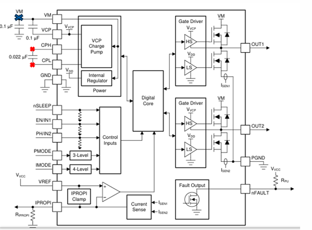

  • Hello Josua,
    Kindly find the response below:
    1.What does other circuit mean, just want to make sure I am not misunderstanding what you mean with this statement?
           Ans:
     There is another test case where the VM is kept floating and the output is connected to the battery voltage. This test case lead to instant failure of the circuit. The previous waveforms are result seen in that circuit.
    Ans: No, I will collect and share as soon as possible.
    3.When the device gets damaged, what pin becomes shorted or becomes open?
    Ans. The damages seen in Vm and VCP terminals . A  pins are seen in short and burnt condition.
