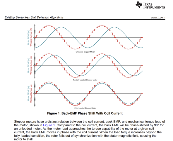

    Here's more specific information about the relationship between BEMF voltage and stepper motor current. Regardless of the current waveform the BEMF voltage will be a sinewave as the rotor spins through the field flux. As well as, the phase difference between the VBEMF and Icoil aka load angle proportionally represents the load torque at the motor mechanical output. With no to very light load, the load angle would be almost 90 ° and fully loaded and about to stall the load angle would be near 0 °. The stepper motor either spins synchronously or abruptly stalls, there is no in-between state. As long as the motor spins the VBEMF will be available, the load angle is what allows detection of the motor stall, or specifically an impending motor stall.

    As described in the previous paragraph, the VBEMF will be 0 at stall - physical stop. With no BEMF factor, the tON will be much shorter time comparing to tON with the presence of VBEMF. However, it may not be a reliable parameter to detect stall detection. because it could also vary with the phase of the VBEMF. VBEMF could add or subtract voltage to the equation depending on its phase at a particular instant.

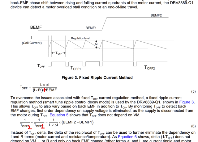

    What confuse me is that in the equation for toff it is (IxR)-BEMF instead of -((IxR)+BEMF). During toff, since VM = 0, the equation becomes
    0 = (I x R) + (L x (dI/dt)) + BEMF;
    dI/dt = -((I x R)+BEMF)/L
    for a short period of time, i assume that dt=toff, and dI = the current ripple(negative)
    which give me:
    toff = LxdI/((I x R)+BEMF)
    This results to toff increase when BEMF decrease, which is completely different from the result in section 4.
    Could you clarify whether I’m misunderstanding the derivation, or if there’s an additional assumption in the documentation that explains this difference?
    The term could be either (I x R) - BEMF or (I x R) + BEMF depending on the phase of the BEMF. TOFF may increase or decrease depending on this.
    Please keep in mind the diagram and the equation may or may not correlate. They are used for high level representation only.
    You are not misunderstanding the derivation part. The assumptions may be related to the phase difference between BEMF and current quadrants in the sine wave current. Further details are outside the scope of our public forum discussion as these are pertaining to the details of a TI proprietary algorithm.
    It is okay for you to go with the below as long as you keep the phase polarity in consideration depending on the time instants. Thank you.
