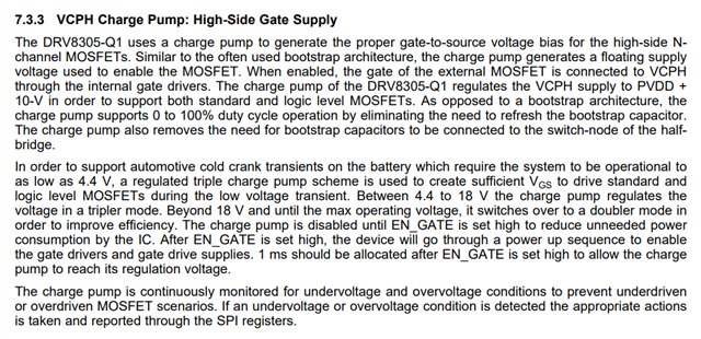

hi expert
Is there any relevant design data and introduction for PIN38 VCPH, which is used to drive mos? Are there any separate precautions?
hi expert
You can find a quick introduction/description of the VCPH Charge pump in section 7.3.3 of the datasheet (seen below)
Regarding precautions for usage, here are some general tips:
1. Make sure capacitors on each pin are the correct values AND correct voltage rating
2. Be cautious of using too high of an IDRIVE setting. If you are unsure which one to use, we recommend testing with the lower drive settings first and slowly moving up if more drive current is needed.
