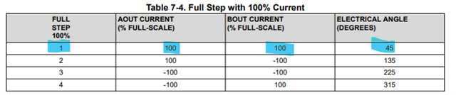

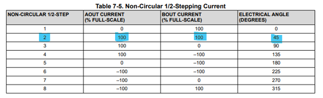

1. Would I know the home state in non-circular 1/2 step mode?
In 1/8, 1/4, 1/2 and full-step mode, it is defined as 45 deg.@electrical angle as shown below.
2. Also FULL STEP 100% is also 45 deg? It is not defined clearly neither on the datasheet.

    The home state is an electrical angle of 45°. Under the Noncircular mode AOUT, 100%, BOUT 100% is home state.
    Yes, it is also 45 deg.
    Please let us know if you have any more questions.
    Mojtaba.
