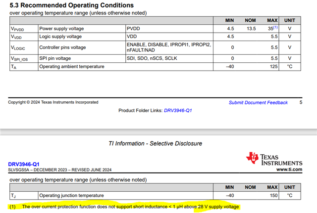

I am using the DRV3946-Q1 to drive contactors and would like to support both 12 V and 24 V vehicle batteries.
  1. 24 V operation: Will DRV3946-Q1 operate correctly in a 24 V system?
  2. Highlighted datasheet: I’ve attached a snip from the datasheet with a highlighted note. what it means and how it impacts 24 V operation?
